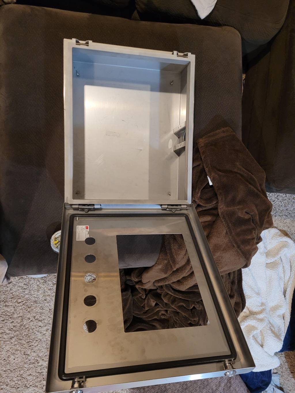

Hey guys,

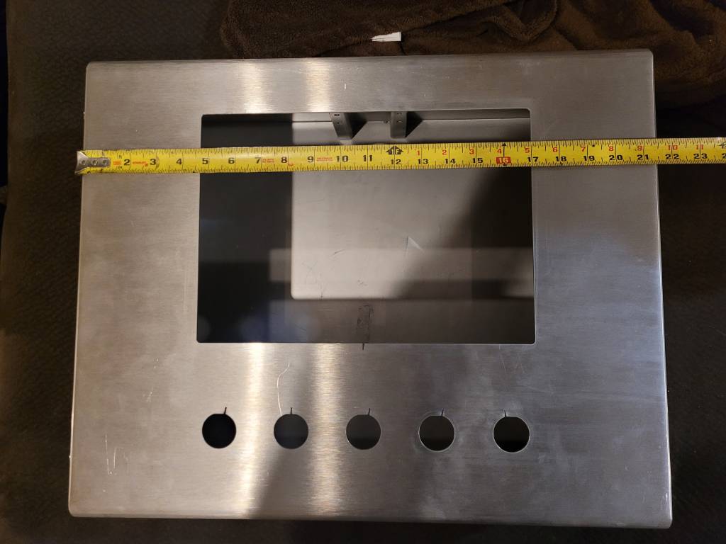

I have grabbed a nice box from my shop and have been planning things out for a nice target box. The other thread here about filler for the box got me to thinking about posting this here to see what you guys would do. Always fun to get some other opinions to see things that you wouldn't normally see.
So the box is from my shop and it typically goes on an industrial machine as an HMI. There is typically a touch screen computer in the large cut out, and your push buttons are on the bottom. Typically a large E-stop then a start, stop, and reset...then anything else a customer would want. This box was scrapped I am guessing due to misscutting or something just wasn't correct. So in the scrap bin it went and that is where I found it and dug it out. The box is made out of thick stainless steel and is very solid. Hinges on the side with locking tabs on the other.
My plan was to put some ballistic material from Super Target Systems, or from Action Target. Then back fill with some mulch. If angling the ballistic material planning on adding some duct seal to the bottom to stop the richocets.. Not sure about the pushbutton holes along the bottom, though something like a long bell target with multiple sized openings could be fun as well.
So what do you guys think would be fun with this box?

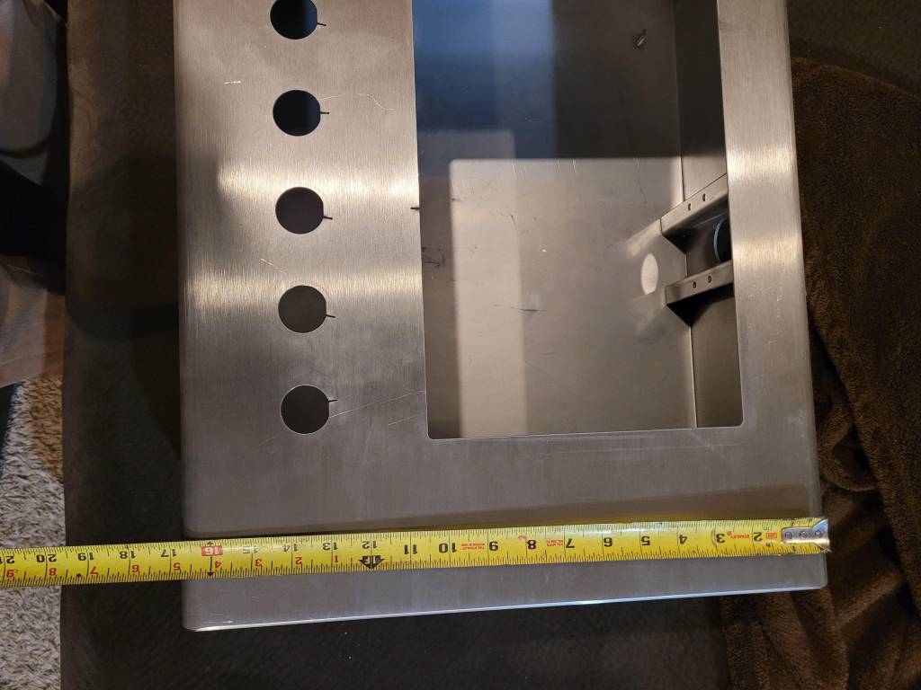

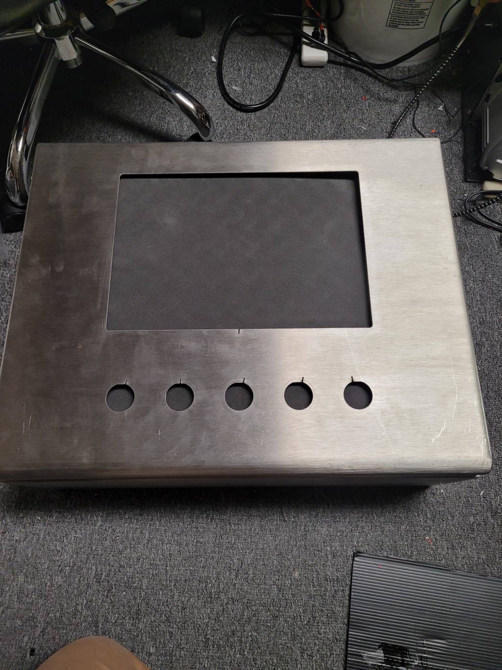

Yeah I checked today and the box alone is over $1k, but being as the MFG messed up the cutting .... we are getting it replaced for free. Notice the cutting for the holes, the laser started on the outside of the hole instead of the inside.
I didn't think about coroplast even though I have a bit of it here in the shop. Planning on grabbing some EVA foam mats and using that as a few layers and then adding that mulch to the back.
Still trying to figure something fun to do with the holes at the bottom of the face.

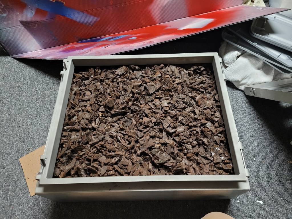

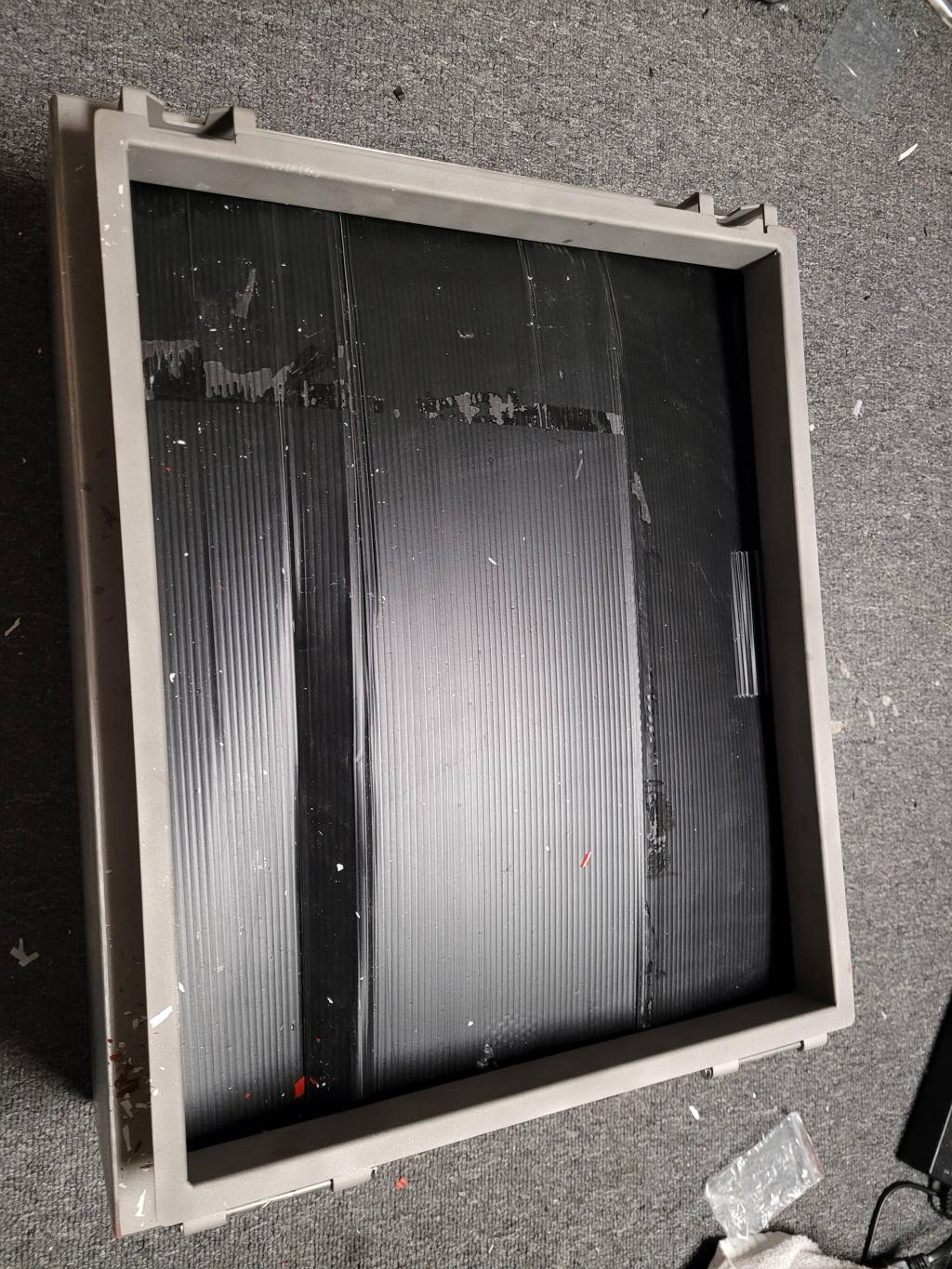

Progress!!!

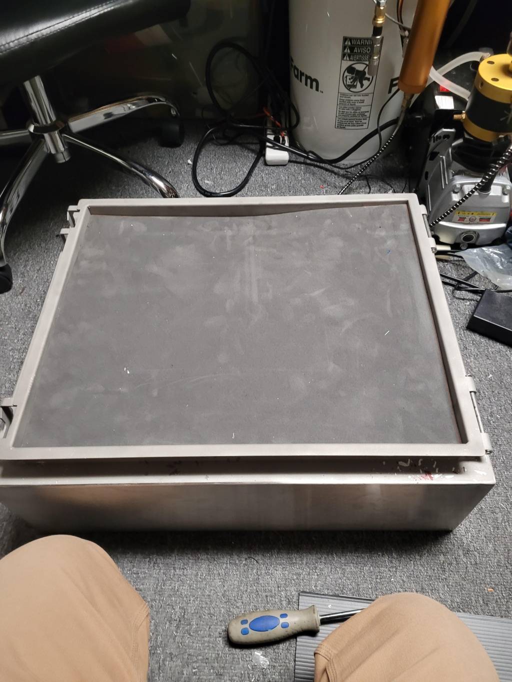

Was able to locate two bags of the Vergo rubber mulch. The box took about those two as well. Filled the box, then secured the mulch in place with some coroplast, then some floor foam on top of that. Then another floor mat to bulk up the foam and to bring the level to the face of the door. Once shut the foam is flush with the face of the door.
A few test shots from around 10' with the .177 pushing 850fps with a 10 grain pellet. The Redwolf on its highest power with a hades pellet. Then the theoben shooting a 25.4 pellet at 820 fps. All solid hits, and nothing passed through and no metal impact.
Should be more than adequate for the target rifles I want to play with in doors.
