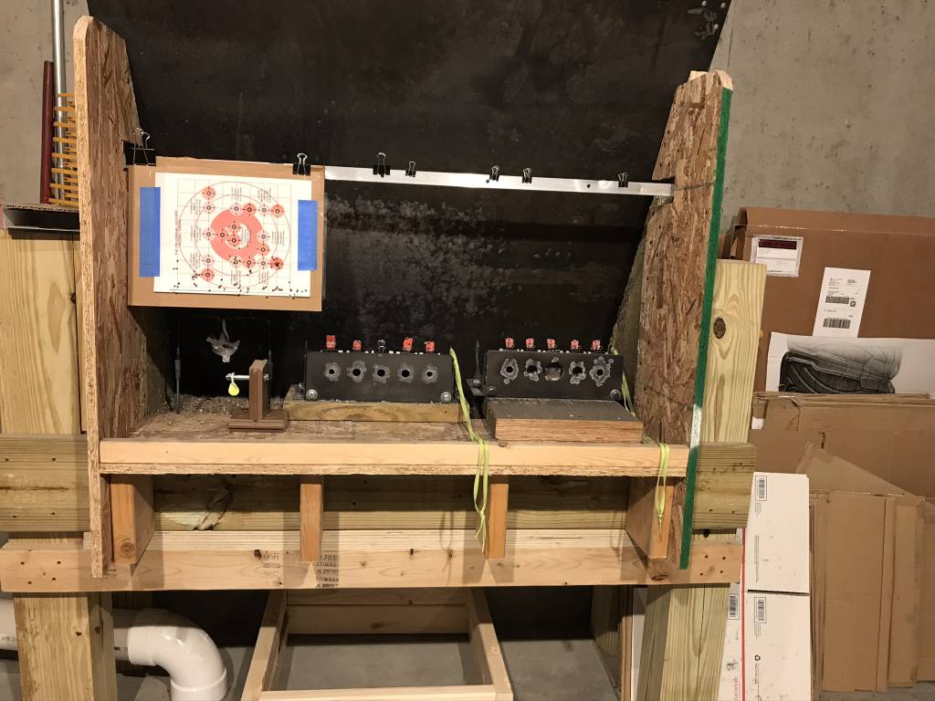

Below is a picture of my backstop, made with 3/16" sheet steel, angled into 8" of sand, equipped with RX reaction targets with 10mm to 40mm apertures. It sits at the end of an 18 yard basement range, with a shooting bench equipped with air tanks and chronograph at the other end. It will take any airgun projectile I throw at it, and the pellets all accumulate in a tight "welded" mass where the steel hits the sand. I do get some residual pellet spray residue out the front from misses that hit the flat RX face plates. The range is equipped with flood lights and exhaust fan.
