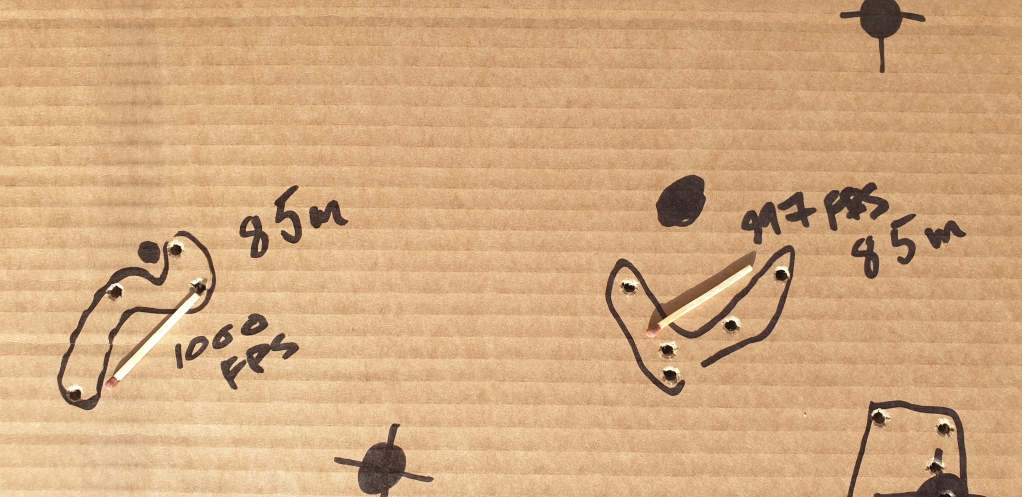

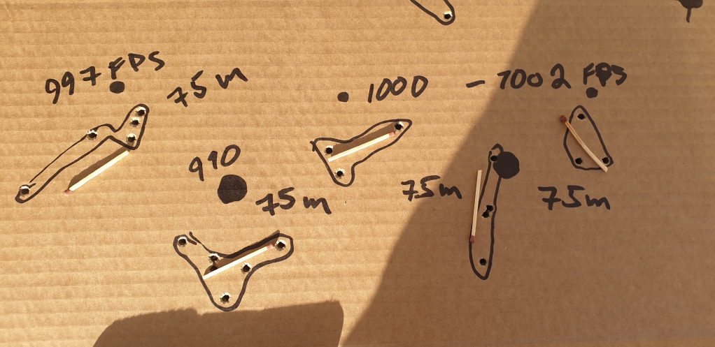

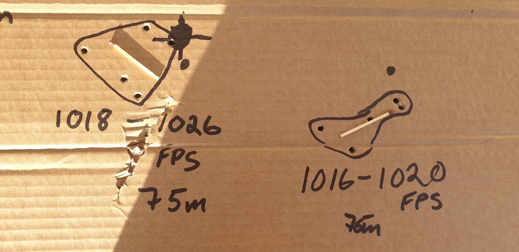

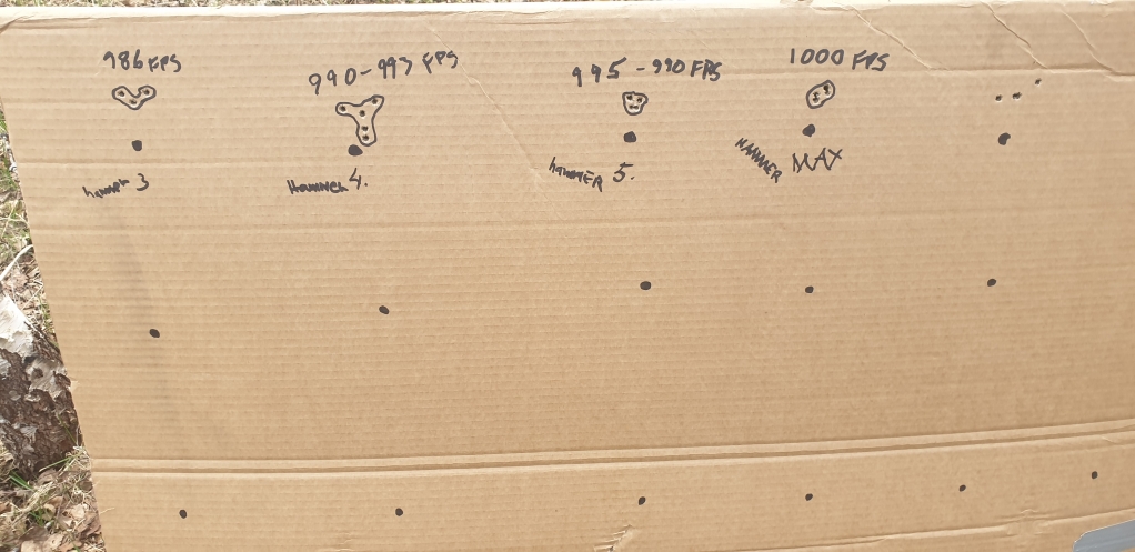

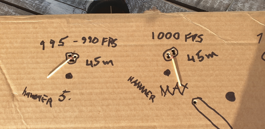

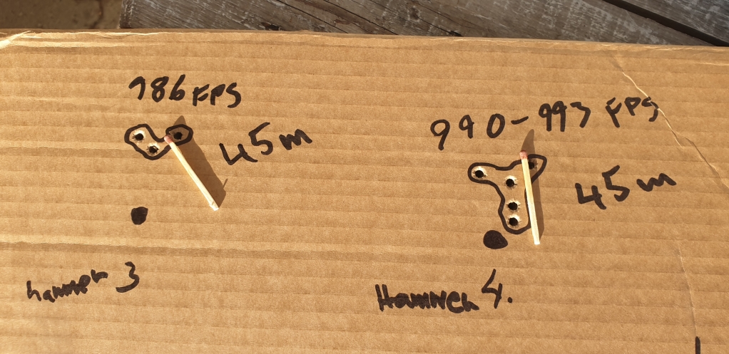

here are some results of four hours of test shooting..
45m (49yd) = very good accuracy
65m (71yd) = ok accuracy
+70m (76yd) = something happened and the accuracy went really bad..
and I really try many many different fps and pressures etc.
I got the best results at fps 990 - 1020.. lower velocities than those caused even more scattering.. 950 - 970fps was very bad..
I am a novice, I know that, but still this is something strange if you compare to other slugs and pellets and harmonic tuning is more difficult.
Those pictures are taken from the best shots so .. maybe someone could help me and tell me why this is happening..
I think one possible reason is poorly finished hollow point.. because it affects the aerodynamic and I notice many bad "flyers"..
