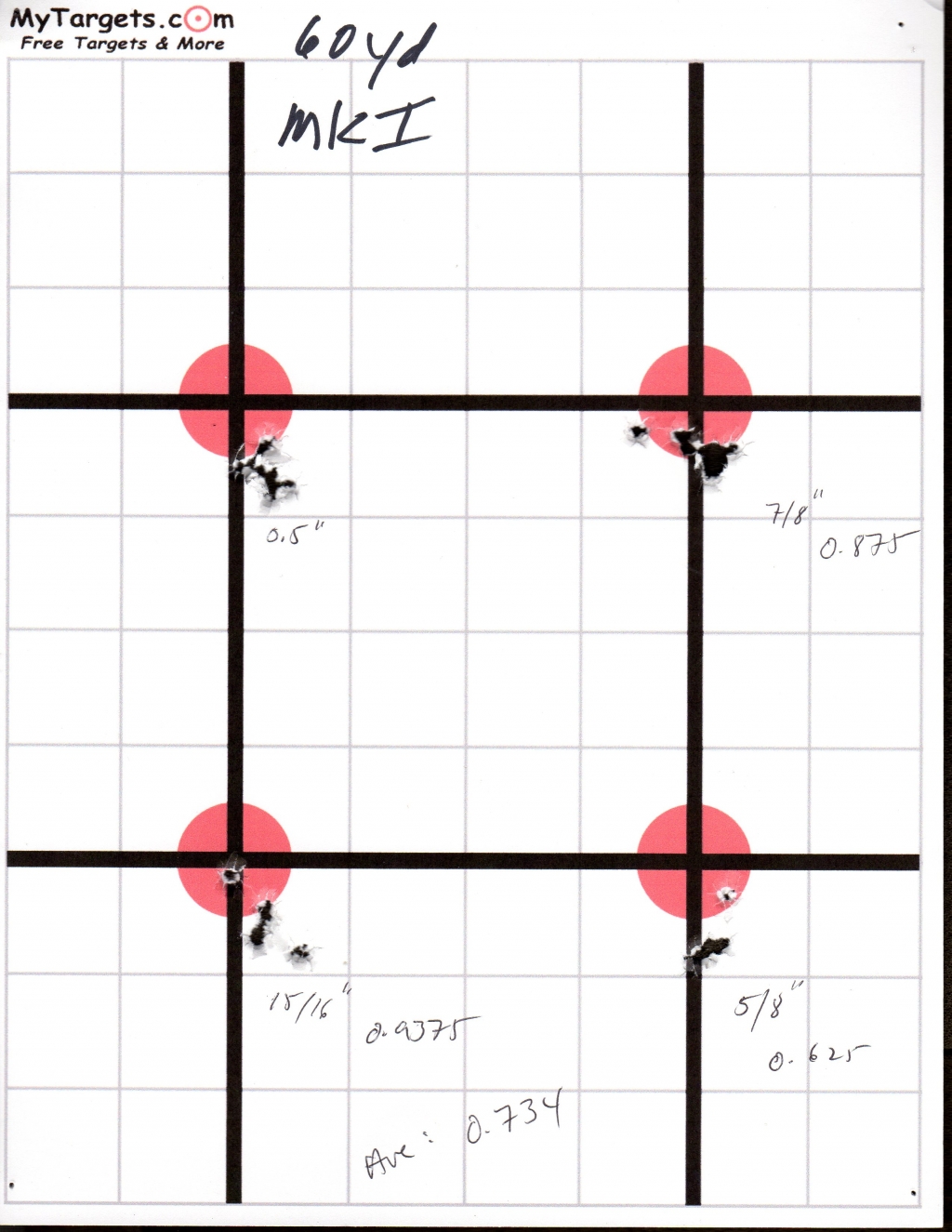

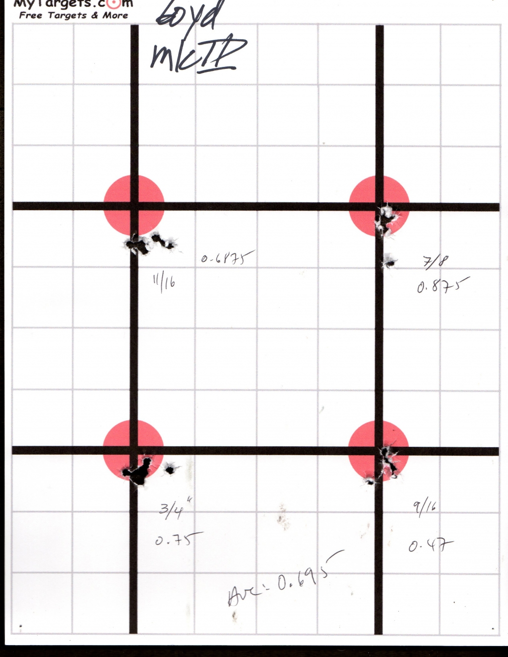

Well, dang it. Thought I was done. After reading your reply above, Chuck, I’m going back in. But it’s all good. I had indexed for highest POI but now I need to hunt for the tightest group. I didn’t think rotating the barrel liner would also have an affect on groups. But there you are.
So before going back in, I’m shooting at 60y with MKII I’m getting average groups of 0.695” with best at 0.47”
With MKI it’s a bit more at 0.734” average and best is 0.50.
Shooting at around 145Bar for 890 f/s out of my gen 1 Imact.
The saga continues.....

Just a note. With all groups I get that one flier while 4 group in a ragged hole or touching; otherwise those groups would be amazing. FYI this is Pellet liner A. Pellet washed and lubed w Krytech but not weighted or sorted.
Pictures of targets from the last post I made above.

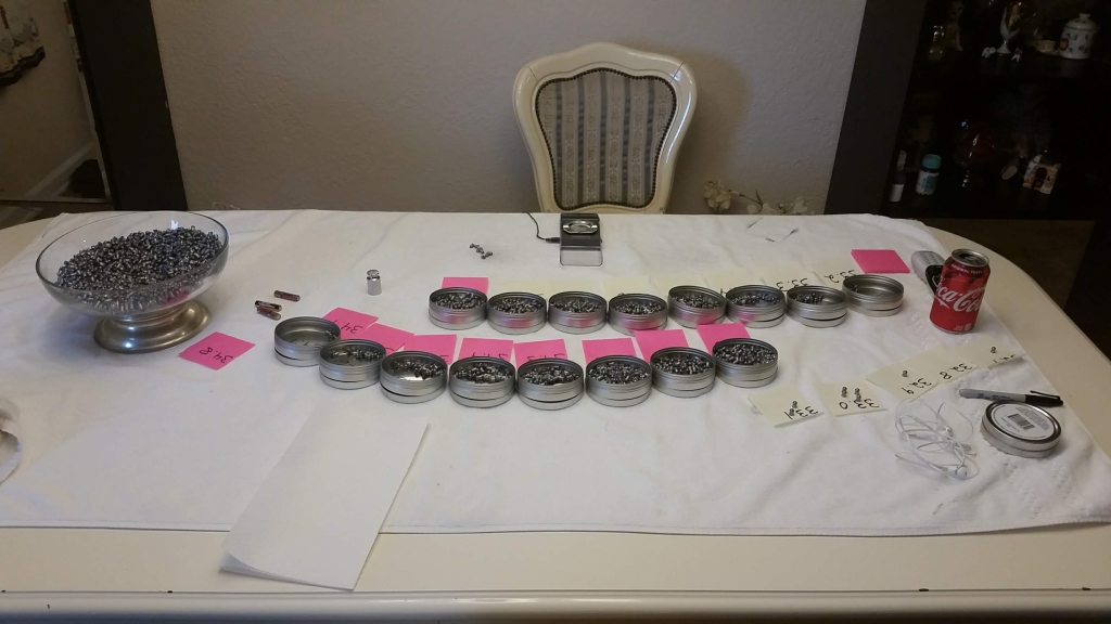

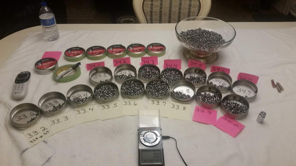

HA! The groups look great except for the dreaded flyer! :) I know it is a lot of trouble, but if you want to eliminate the flyers try cleaning your pellets and then weighing them to one tenth of a grain like I do, and instead of Krytech just try lubing them with Napier Pellet Lube. (NapierUSA) When I weigh these 34 MKI or MKII I get weights ranging from 32.8 grains all the way up to 34.9 grains and everything in between. Here is a pic of that for you...

Great photos of your elaborate setup.

Drumsnguns, the majority of pellets will weigh from 33.5-34.4 grains. You just have to shoot some of each on a nice day and see which ones work best for you. I have a .25 Wildcat Original with the Smooth Twist barrel and the most accurate ones for me are the 34.1 & 34.2... I call these "Magic Beans"! :) I love to watch them drop through the same hole on the target at 50 yards just effortlessly...as if they had GPS and know where to go all by themselves! I save the best ones for special occasions and shoot up all the oddballs for plinking at steel spinners.
Some thing else you will notice when your shooting pellets over your chronograph that all weight the same to within a tenth of a grain is the vast number of "duplicates". Sometimes its as if your chrono is stuck on duplicates! I have my .25 Wildcat set up to shoot the MKI at 895 ft/s...with an extreme spread of 4, and a standard deviation of .86 ft/s. Not long ago I shot her over my chrono just to see whats up and got 897 ft/s seven times in a row! The only gun that I know of that equals mine is my friend Gabe Rossi's .25 Streamline. The first time we set his gun up together so he could learn how to do it, but I have to admit that the student has surpassed his teacher now. He is a member here and one hell of a shooter. If he ever offers to shoot against you for money, don't walk...run away! :)

Yes I clean them all with acetone first and then I clean them a second time with denatured alcohol, which leaves absolutely no residue. Then after they are completely dry I wear them to within a tenth of a grain and put them in clean cans with the weight marked on the lid. So that when I'm shooting everything in the magazine weighs exactly the same. I haven't seen a flyer like the ones you're getting since I started doing this so all I can say is the proof's in the pudding.
No, I throw the foam away because it wants to suck up the Napier off the pellets. I am not worried about the skirts of these big 34's because I am very careful with them. I spray a couple shots of Napier into a small Zip-lock back and then put the pellets in the bag and roll them all around. Then as I load my magazine I roll each pellet between my thumb and finger to make sure it is evenly coated. I don't care for spraying the Napier directly on the pellets because the inside of the skirt well on some of them gets loaded with it. Your welcome Drums...I believe you will be glad you did.
