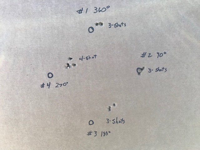

Indexing at 10 meters with my .22 Impact, 18.13 JSBs, 2 shots per position, looking for best position for elevation purposes. At that distance I didn't expect to see much difference in accuracy from one position to another. The blob at upper right outside the circle was my aiming point.
Ladwict, if indexing changes POI then your liner is not perfectly straight. No big deal, few are. It also means that shroud/O-rings/jam nut at muzzle end are not eliminating the curve in the liner, otherwise indexing would not change POI.
I would bet anything that the frequency and/or amplitude of the liner oscillation is different for different indexing positions, which is why some notice tighter groups at certain positions. That just means that for that projectile, at that velocity, at that index position, the projectile is leaving the muzzle on an antinode of the liner oscillation.
Anytime you change velocity, regardless of indexing, you are changing the amplitude and/or frequency of oscillation. But you are NOT changing the fact that the muzzle points in a certain direction when indexed in a certain position. Therefore I would expect you to get roughly the same POI, but with better or worse grouping.
Long way of saying that a change in velocity is a change in harmonics, indexed liner or not. I'll bet there is an optimum velocity for ANY index position, and when you index and find one position gives the best groups, that is true only for that velocity. That answer?
