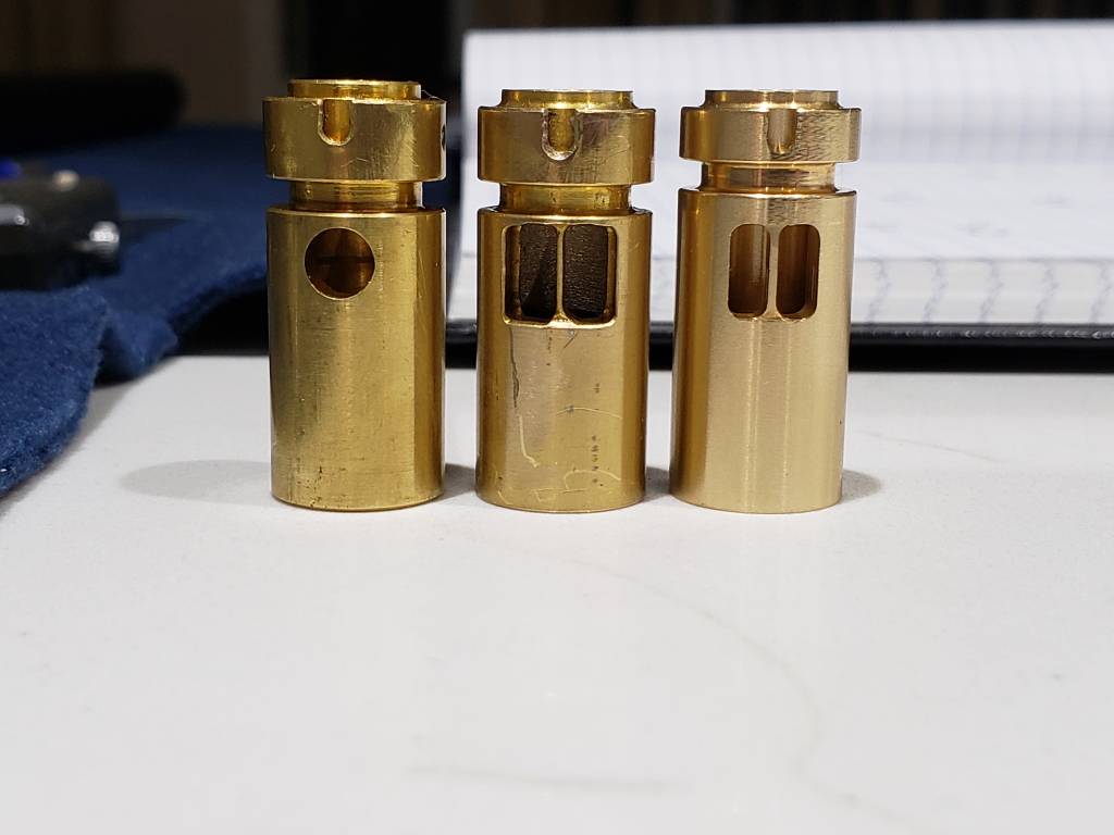

I had the DIY enlarged Huma dual port with enlarged FX pellet probe (in the middle), the speed was maxing at 960 fps with 34 gr MK2's and 119 bar maxed out HS
I just swap to this new Huma dual port (a new kit that comes with the dual port + pellet probe as well) and lost about 30ish fps, I did not enlarged these pocket openings yet. Same reg pressure 119 bar HS maxed out.
Next thing I will try Ernest 45 degree port pocket openings, if any good. I have one spare brass piece still stock.
yes.. I also have the huma tp and prob installed on my impact 700mm .30 barrel kit. at 130 bars, it shoot at 978 fps (after replace 52 mm with 57mm spring) with 44.75 grain jsb pellet. it has 95 fpe, 129 joules. it seems powerful enough for me 😄... at this stage.. I only want to shoot 43 grain slug at around 960 fps.. it would be sufficient at my initial stage..
