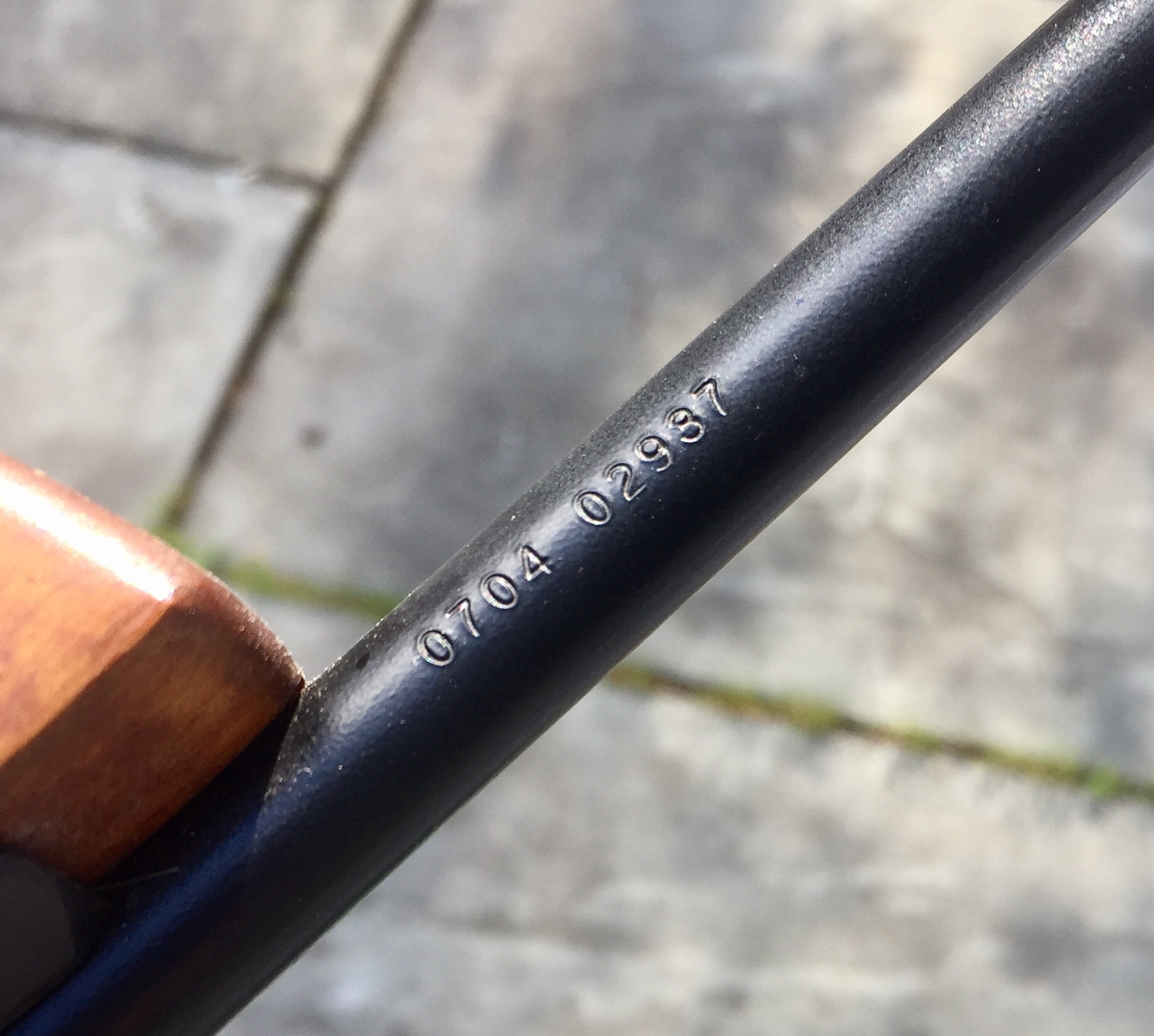

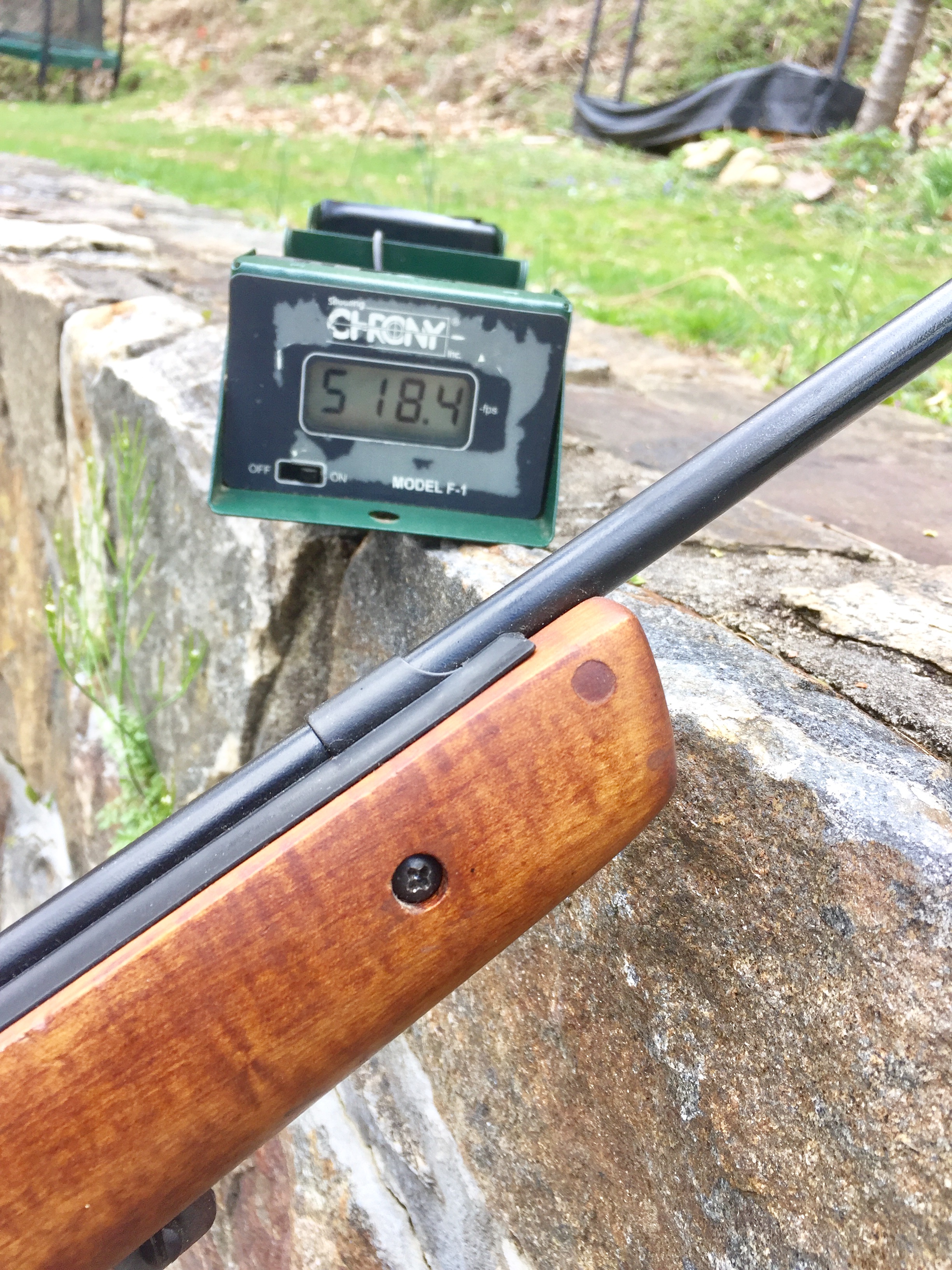

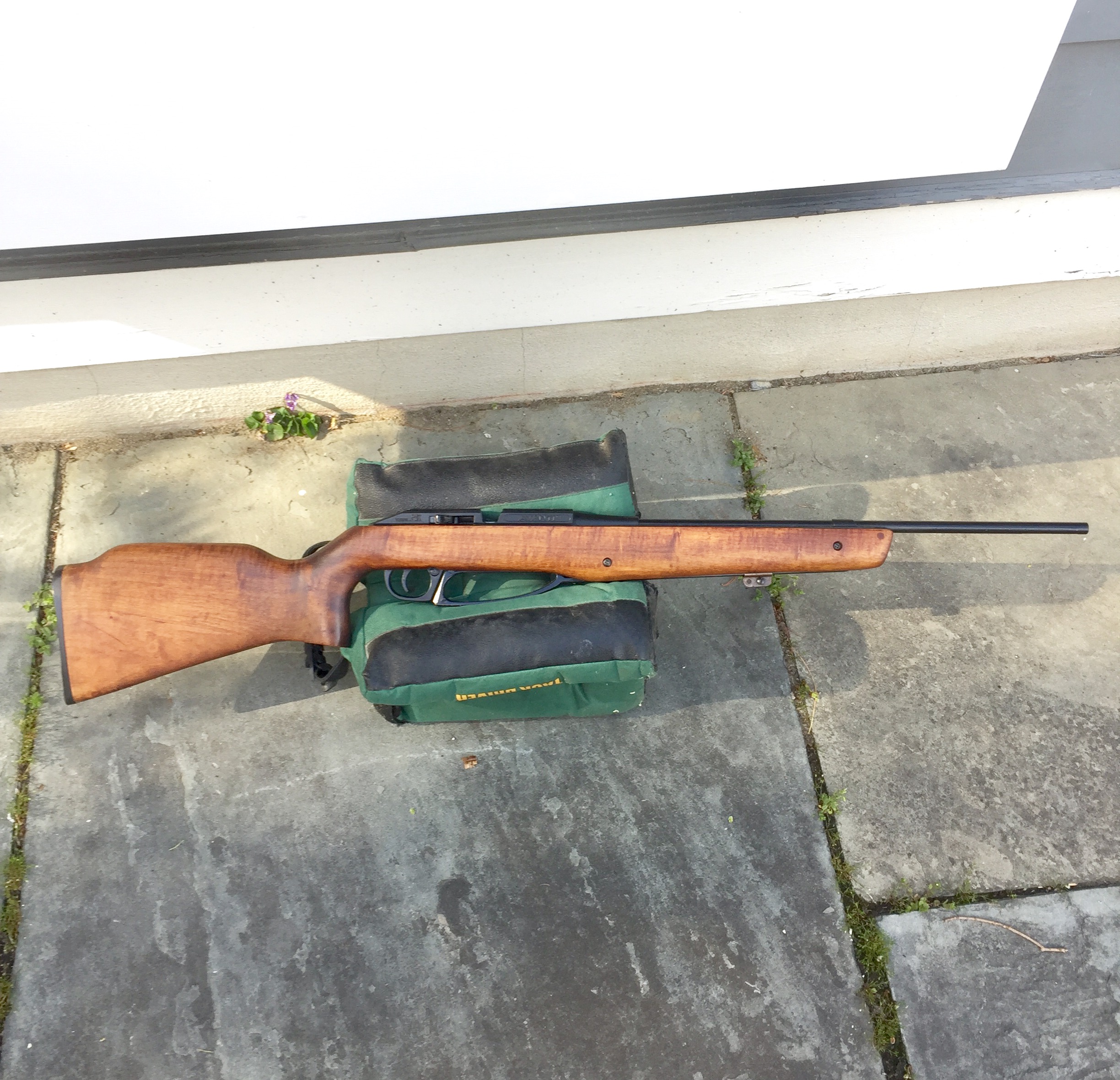

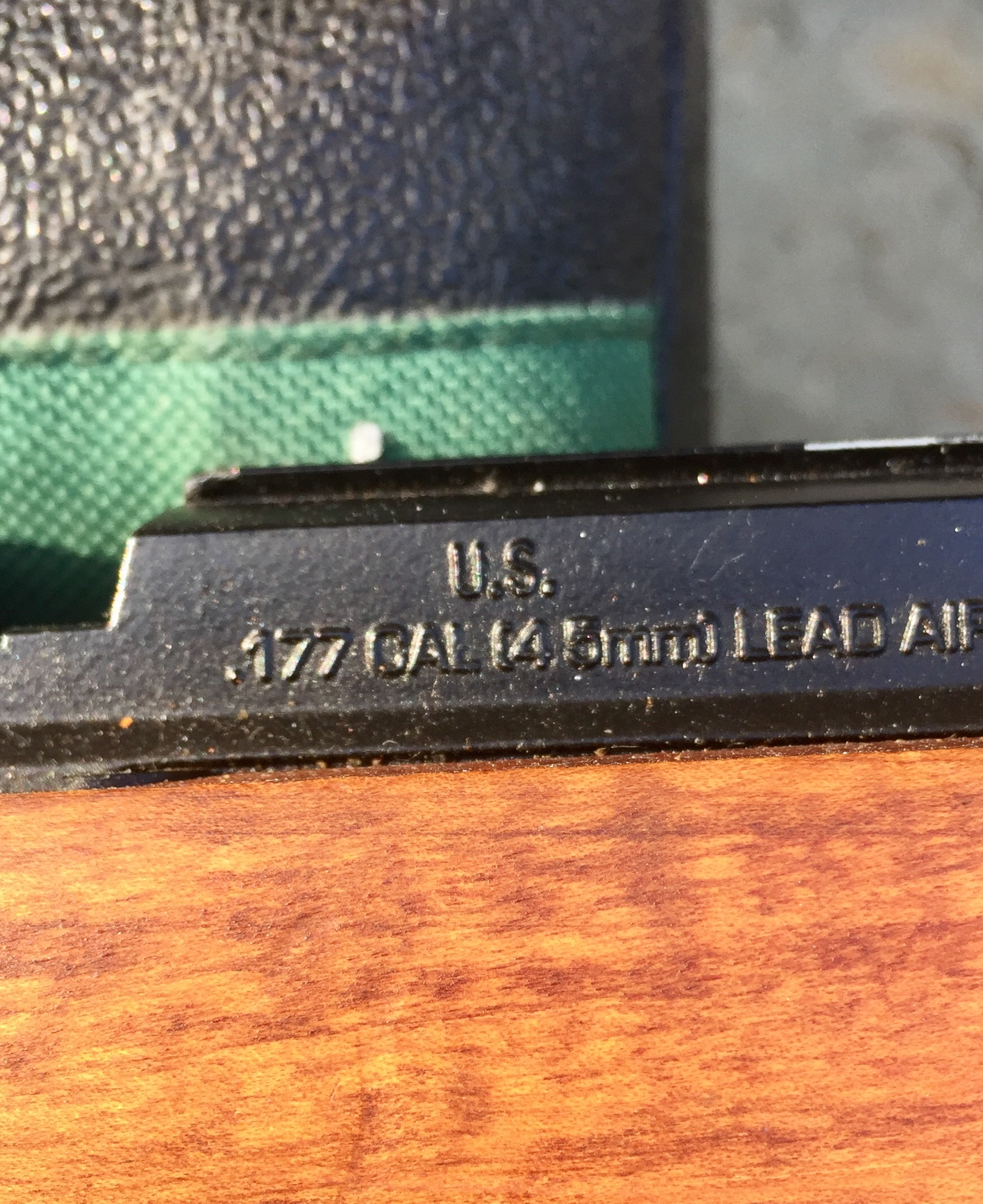

Single-stroke daisy 853's from the CMP, see link below;
$125 plus shipping and they come to you freshly resealed and shooting well north of 500 fps, also they come with a Lothar-Walther match barrel. Also, they're grooved for scope/sight & receiver is "US" marked. Mine literally stacks pellets out to 20 yards easily.
