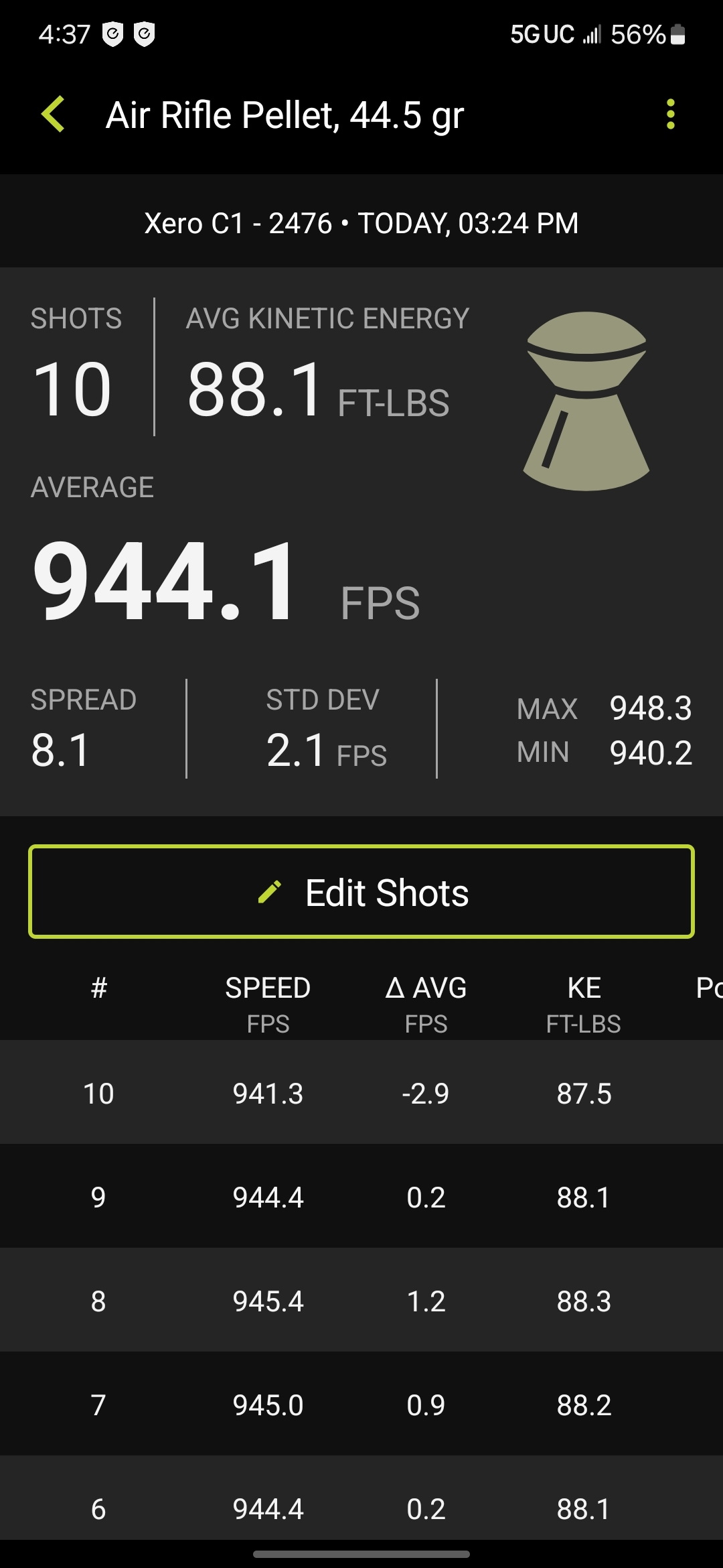

Johnsmith120 I feel your pain. I also have an M4 that is inconsistent. Here are my settings;
FX M4 Impact, 30 cal, 700mm, Vortex crossfire II 6x18-44 scope
45yds range
Reg: 130bar
Macro: 16
Micro 5
Front Valve: 4+1/2 turn
Pellets 30 cal 44.5 gr FX Hybrids
Recently (200 shots ago) replaced my stock 1:40 liner for a 1:16 STX superior heavy liner.
The 1:16 shoots slugs better than the 1:40. But 44.8gr Hades shoot better out of 1:40 as you might expect.
Today, using the heavy liner I was getting .60-.70 groups of 5 shots at 45yds. Then next shot is 1 1/2" north?!?!?? Next shot is low left by an inch?!?!? Then three next three are high an inch, but stacked on top each other.

Micro at 5 is likely too much at 130bar. But maybe not. Stock hammer seems to be capped anywhere from 125 to 135bar. My M4 700mm gives me around 97% of max speed 20 micro clicks down from 5 at 132bar (it’s a .25 though). You need a chrono to figure this out. Plus, slugs are as*holes to figure out. A .30 Hades will be very humane to ordinary pests ;)
