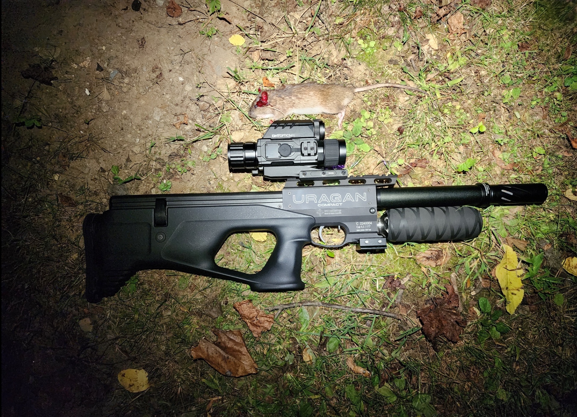

I have always been on the quest to find the most quiet pcp for my use. I actually enjoy shooting the low power stuff sub12 even in .177 and .22 heck I even have a .25 set at 22FPE. The problem is my backstop makes a whack every time. Not a problem when I'm pesting because its 1 shot at a critter but to sight in and practice its loud at 1am. I am currently using my tote with rubber mulch and a foam mat to place thr target on which works amazing for all calibers but its LOUD. I tried an old drop cloth last night and same thing. Has anyone found the ultimate quiet backstop material?
Picture is a gen1 uragan .177 at 11FPE
