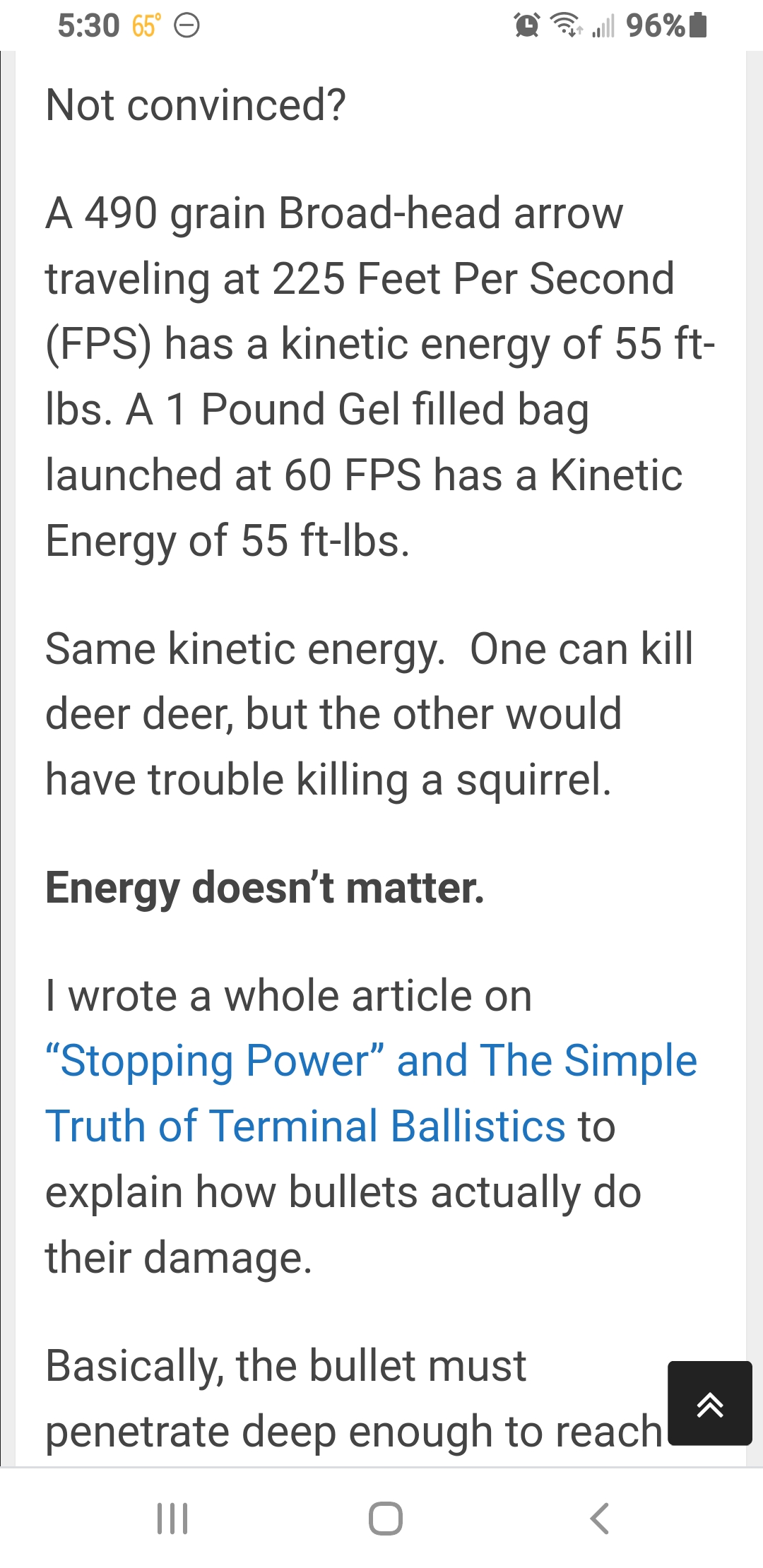

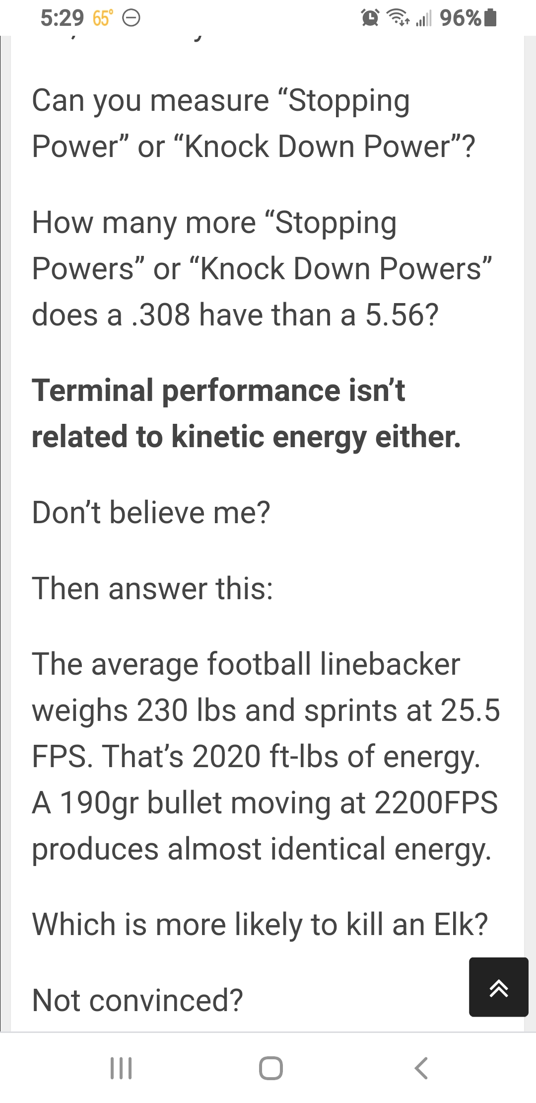

Energy doesn't kill. Tissue damage does. Hydrostatic shock is the only close example of energy dump killing an animal. In the end it's still only tissue damage caused by a shock wave. Unfortunately hydrostatic shock is only possible at velocities that are usually only attainable by centerfire rifles.
A projectile that destroys vital organs will kill. Whether it passes through the entire animal or not is irrelevant. Only adequate penetration is necessary anything more is not detrimental. Energy doesn't kill. Tissue damage does and it has to be the right tissue too.
You take a solid hit from that linebacker and get back to me.
