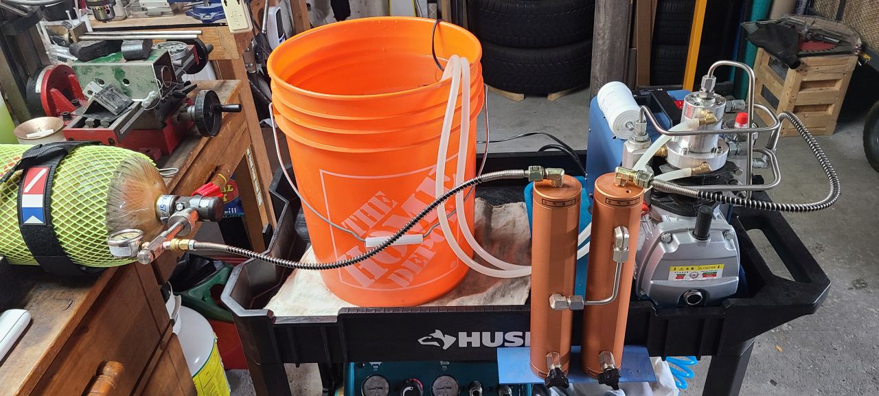

I was running my YH in the unfinished basement, but since I made it habitable wife kicked me out to garage because of the oil smell. So here is my setup.
Big orange - dual stage. In over a year I have never seen any mist coming out from the second stage.
I live in between Great Lakes, my summers are hot and humid and winters cold and humid. Today for example it was 4C and 75% and I was filling that 14L tank after a weekend range time.
