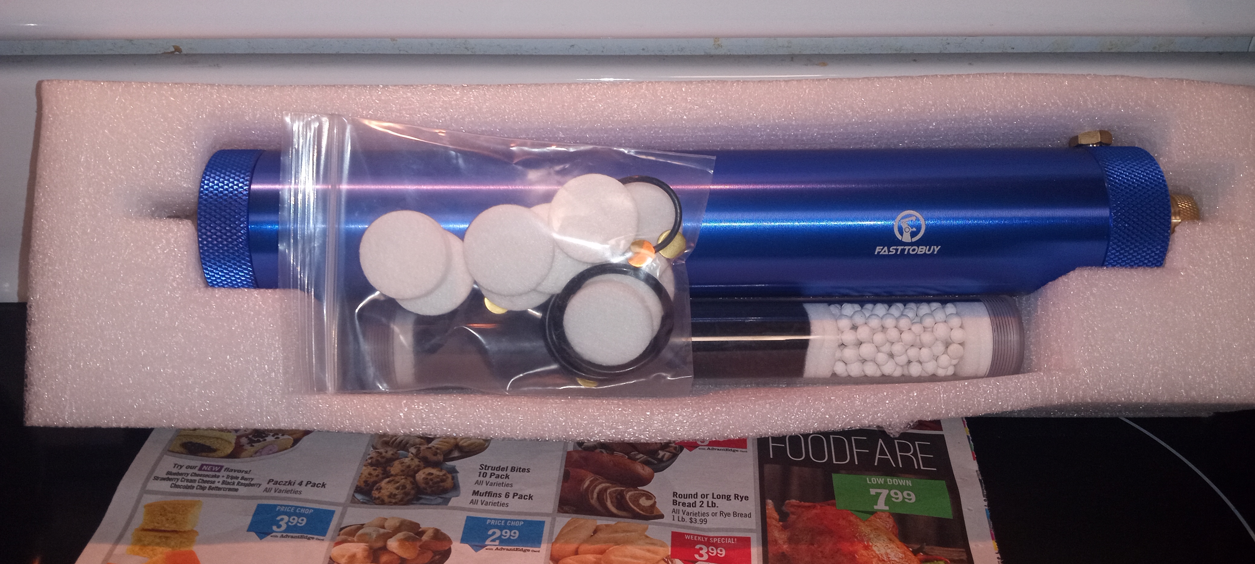

There are many filters on amazon/ebay of various quality. The question is which one is the same as the high priced ones someone put an expensive label on? Even the expensive ones are made the the same Chinese guy so how much you are willing to pay for a label is up to you.
Obviously the challenge is to find the good ones on Amazon, but thankfully they have free return policy.

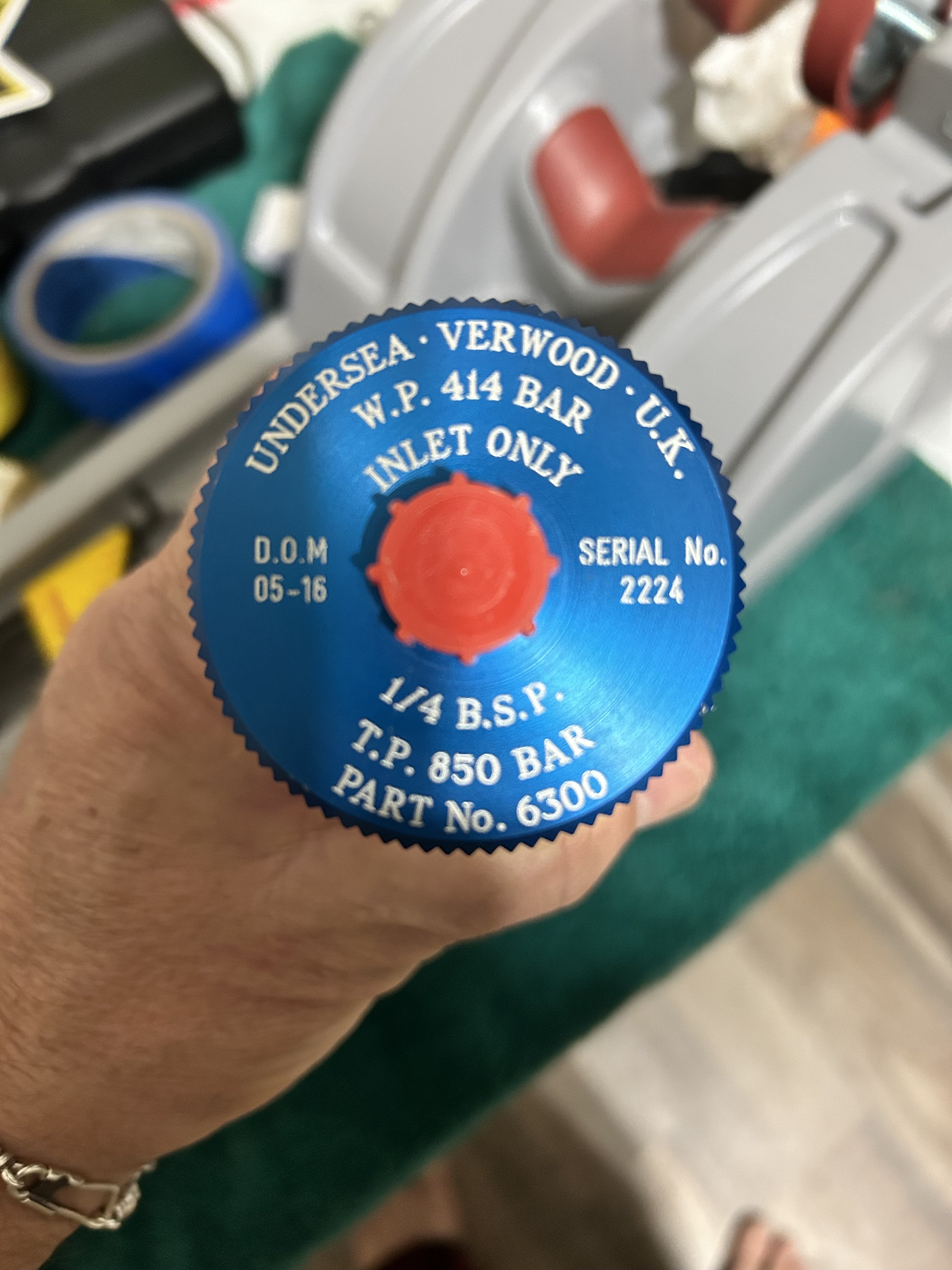

I bought this one years ago, working pressure 414 bar. It’s made in England so I’m sure it’s safe.
Pics of my actual unit……
