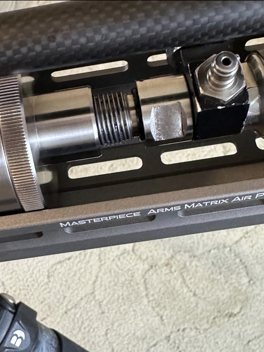

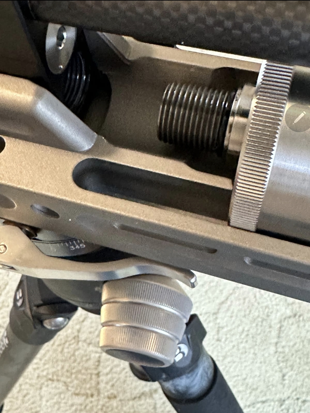

A US based user asked me to make an inline plenum for his longer stock RAW HM1000X. But I didn't have complete specs of his after market stock.
Whatever was provided to me, I made the plenum according to those specs.
He got the chance now to install it but found that there are some differences in actual specs of stock due to which the initially sent plenum is useless.
Now I plan to make one more as now I have got better specs.
Pics are hereunder.
Pics are hereunder.
View attachment 441472View attachment 441471View attachment 441470

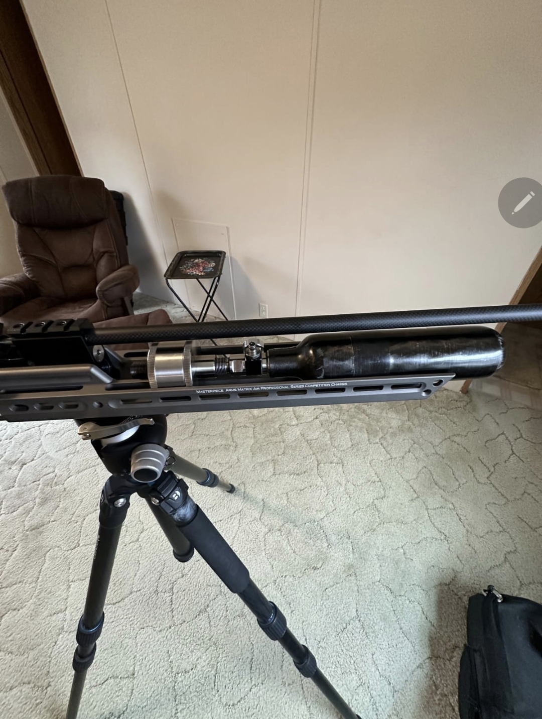

Morning all - as a proud Owner of an hm1000x I am looking for advice. My goal is to swap from the buddy bottle system onto a main tube modification for the air reservoir. This way I get a rifle that matches my other target rifles and also gives way to being able to fully shroud the barrel also without need for threaded moderator on the end.
Who can offer advice on having a main tube made to fit and replacing the buddy bottle altogether. I’ve scoured the net for days to no avail
Kind regards
