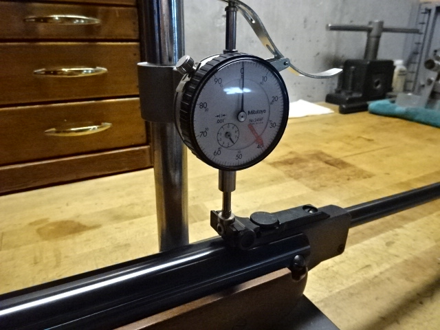

In case you didn't know....
Each click of the elevation screw on the standard Weihrauch rear sight equals .005 of movement. I am not missing my Leupold scope yet.

Nice instrumentation you've got there. I believe 5 thousandths equates to 1/4" at 40 yards.
