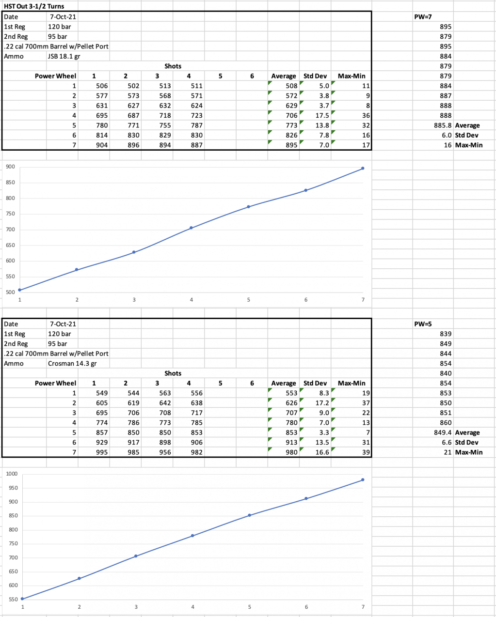

K, this is the best I could get and it's still not what I'd like to see. Same reg settings as before, 120/95 bar. I fully screwed in the hammer spring tension adjustment screw and then backed it out (3-1/2 turns) until I got my target velocity for JSB 18.1 gr pellets on power wheel setting 7. I then made a 4-shots though each of the power wheel settings and then a 10-shot string at the power wheel target (7 for 18.1 gr and 5 for 14.3). Should be clear. Wonder if the 2nd reg being nearly closed is not ideal. Maybe I should go up to 110 bar and reduce HST?

As others have pointed out the accuracy and precision of the FX gauges are not ideal, so I ordered a Sekhmet. I the meantime I pulled the gun apart cleaning and lubricating as appropriate. Also, my 2nd reg had 12 Belleville washers installed. I wondered if that was why I had no low end on that reg, barely cracked read 95 bar. So, I only installed 11 spring washers. Upon reassembly I think that may have been the primary culprit. Certainly have adjustability from around 50 bar on up. My regs are now set at 115/80 bar. I adjusted the HST adjustment screw 1/8 turn at a time and settled on 5/8 turn out from full in. Shooting 18.1. gr JSBs at PW=7 produces 905 FPS with a SD of 3.8 and ES of 10.
