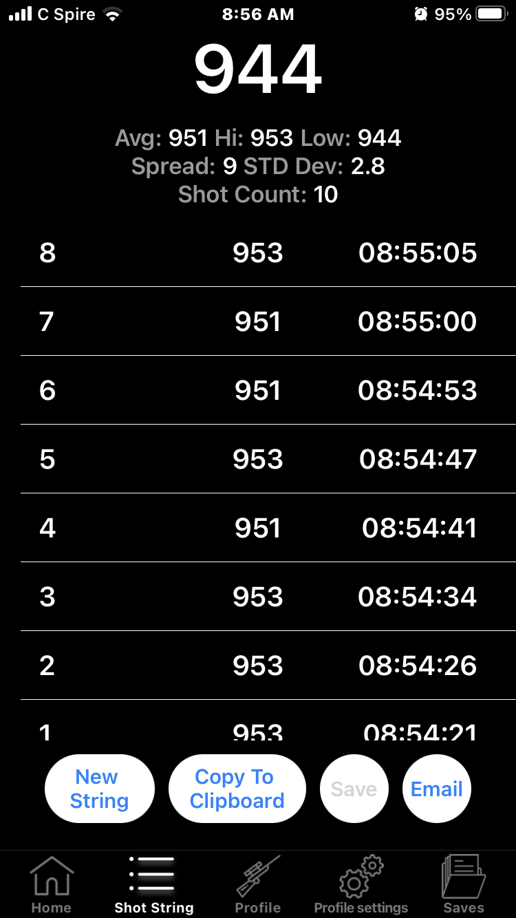

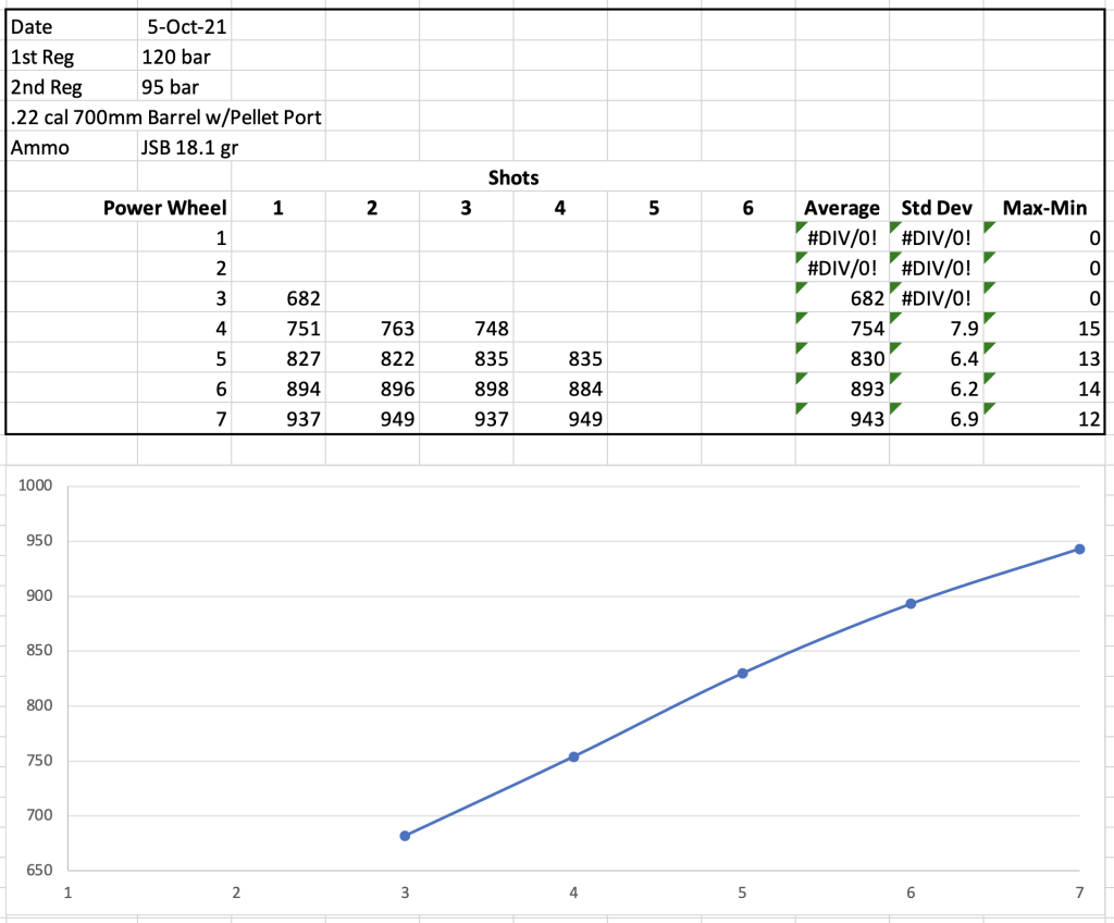

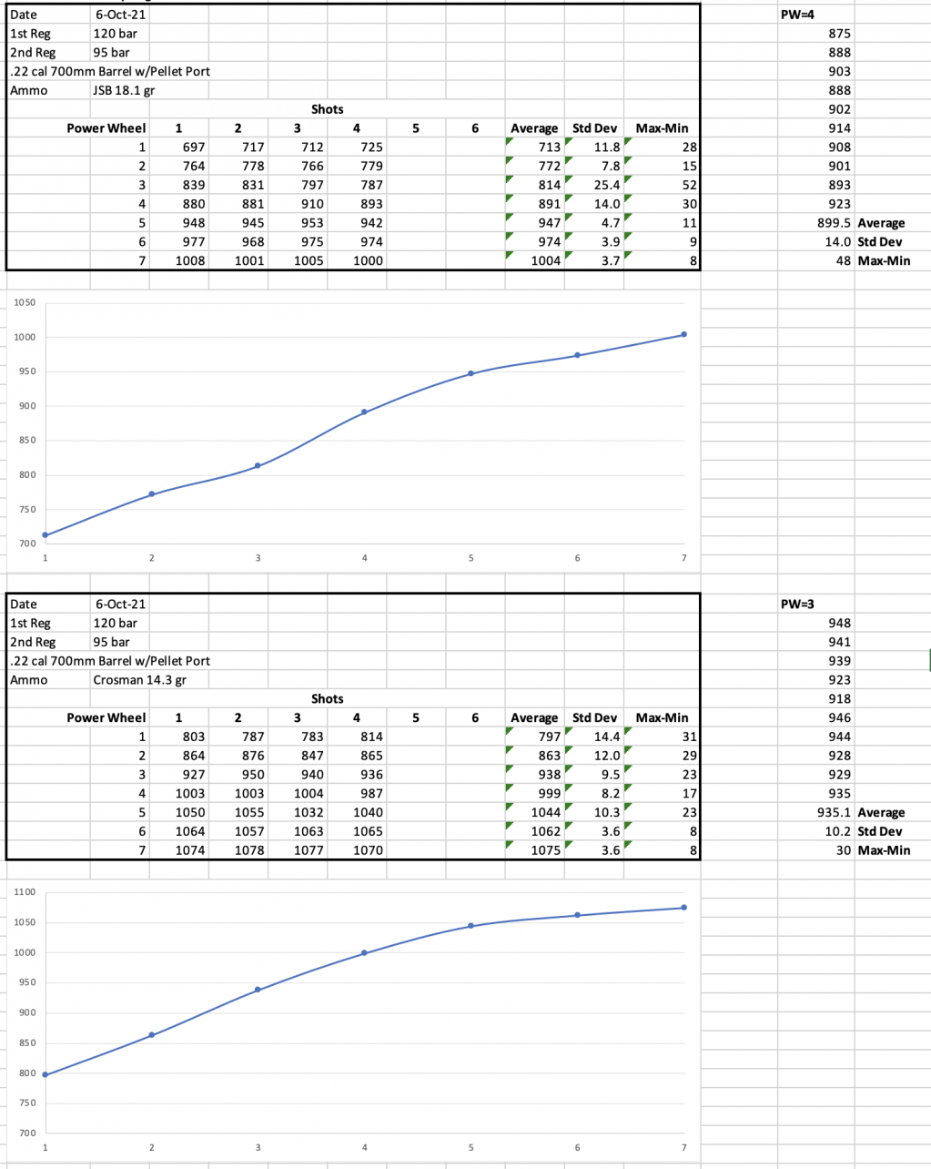

As others have pointed out the accuracy and precision of the FX gauges are not ideal, so I ordered a Sekhmet. I the meantime I pulled the gun apart cleaning and lubricating as appropriate. Also, my 2nd reg had 12 Belleville washers installed. I wondered if that was why I had no low end on that reg, barely cracked read 95 bar. So, I only installed 11 spring washers. Upon reassembly I think that may have been the primary culprit. Certainly have adjustability from around 50 bar on up. My regs are now set at 115/80 bar. I adjusted the HST adjustment screw 1/8 turn at a time and settled on 5/8 turn out from full in. Shooting 18.1. gr JSBs at PW=7 produces 905 FPS with a SD of 3.8 and ES of 10.
