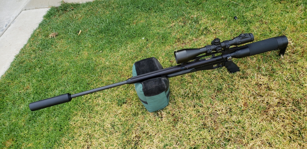

Here is a customers 30" 257 condor. Waiting for me to finish up the reg setup
Doug
