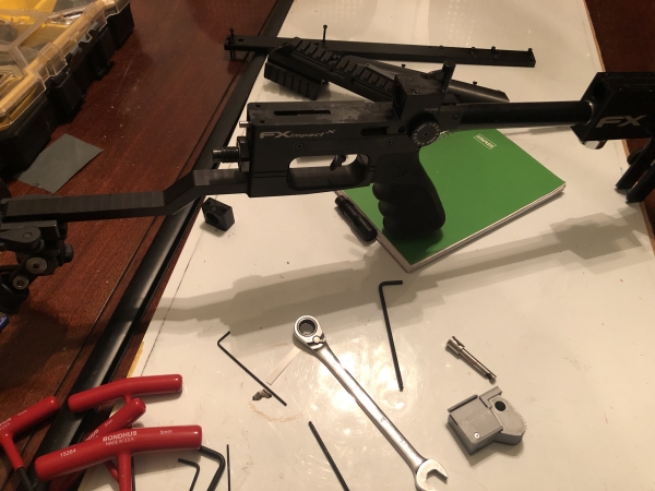

Im not sure what the isssue is, I swapped the 22 barrel out for my 30 cal and it's the same behavior - it just doesn't have the umph anymore. Does this ring a bell for anyone? I've got it opened up tonight (I wanted to get a feel for the hammer and internals)..

  • My valve housing is in there pretty good, like REALLY good. The first thing that I noticed after taking off the top plate was my entire rear action via the long black valve tube was turning freely. There's a big socket cap screw right above the rear top of the pistol grip area that looks like it's suppose to keep the tube tensioned down, whoever assembled this Impact must not have cared much and they just Loctite'd the crap out of it without making sure it was secured.
I'm not sure that I want to put the tube in my vice to get the housing off right now. I have a decent enough visual on the valve seat to see that it looks in tact all around.
Nothing else that I'm seeing appears to be worn or broken.

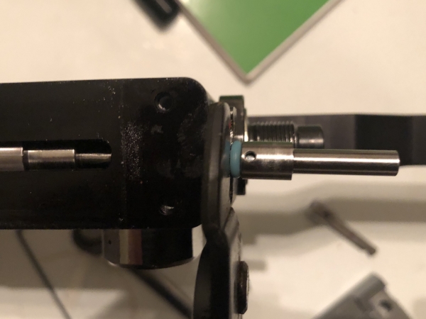

If the c3 bumper is different than factory, that will affect how the knob works, I can see a green oring there, not recommended, since also affect hammer performance (too soft or thick) and might lower your spedds as I recall ER told me once (normal orings not recommended) too much cushion. Green orings are too soft (70) you need at least 90 or more
