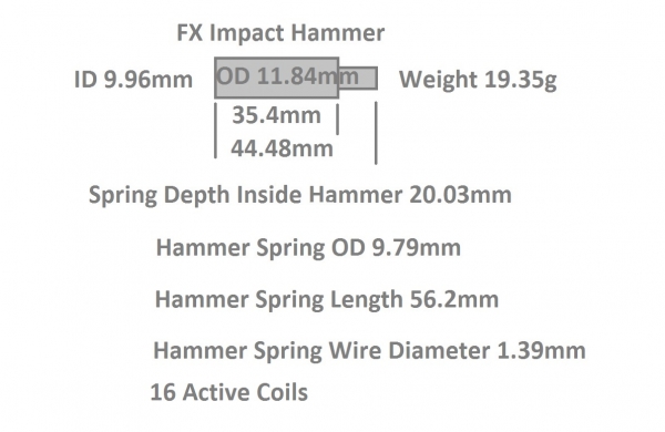

This is from that tread
1544149406_14284806495c09d99e816133.33870569_1AF4EEEC-180D-4DA1-B5E1-36AE4F3F24B5.png
