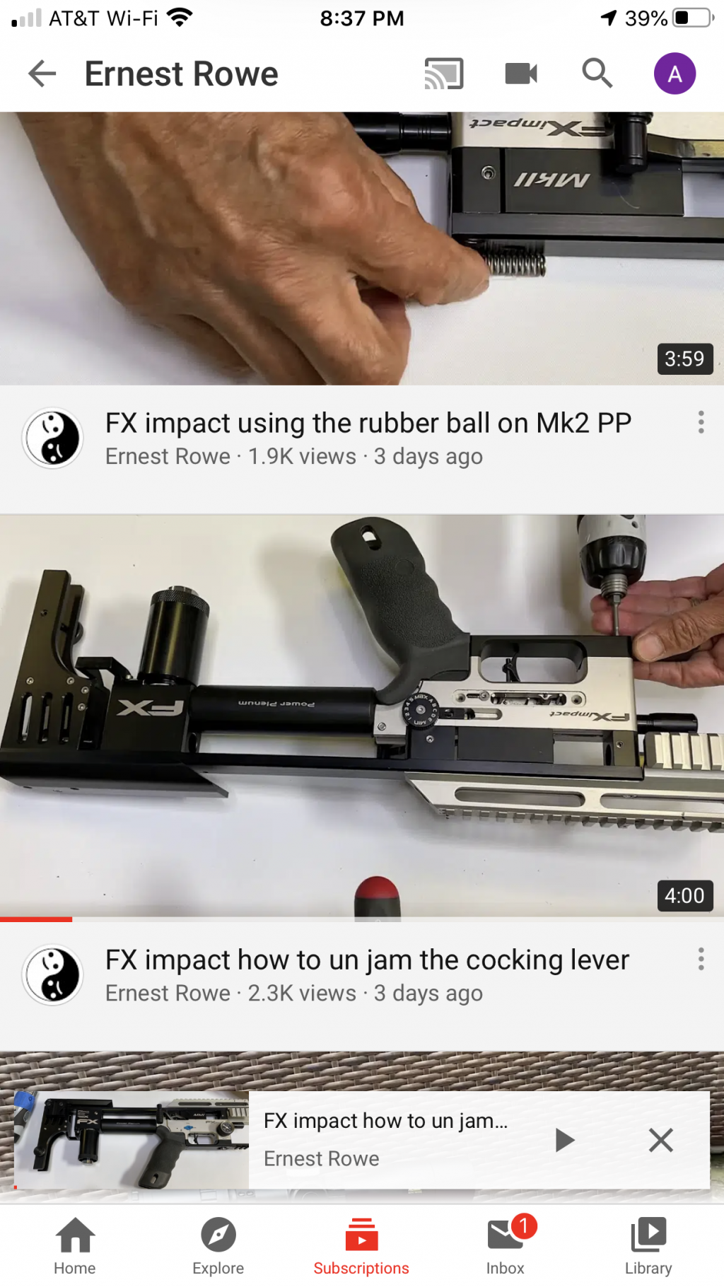

So I was watching YouTube and came across a video that Ernest posted and seen he had a power plenum and external plenum

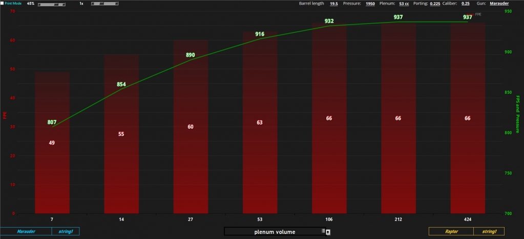

I literally gave you the most technical answer possible. It really depends on how much FPE you intend on putting out. A .177/.22 shooting pellets won't benefit nearly as much as a .25/.30 cal shooting heavier pellets or slugs..anything over 2 fpe per CC of plenum volume has diminishing returns. This is because during the shot cycle, your plenum pressure drops based on its volume and the volume you eject from it, but once the ratio of that is surpassed by meeting the 2 fpe/cc criteria, your pressure drop will be so low at the valve seat, that any increase is negligible...this graph shows how critical it is to be at least 1/4-1/2 fpe per cc, and 1 fpe per cc is a great middle ground, and 2 fpe per cc is close enough to peak to not consider going further...this scales with all calibers and power levels.
