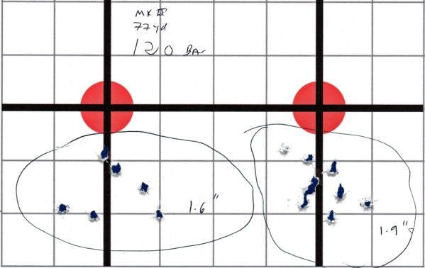

I followed Matt's video and photographed all of the targets to show what different reg. pressures do to groups to give a visual of what happens.
All other variables were left alone for each reg setting. I used settings from my initial tune so the hammer spring setting was on MAX with the spring adjust screw at 15.66 mm. Valve was wide open at 4 lines.
I turned the regulator down to 120 bar to start, shot groups then went up 10 bar each time and shot groups. The gun was refilled after each Bar setting change to 220 Bar.. "NOTE" Be sure to always remove the cylinder and empty the gun before adjusting reg pressure. It's OK to raise the pressure, (counterclockwise), with the bottle attached but I do it for all so I don't forget but that's just me.
I set targets out at 77 yards and shot groups at 120 BAR, 130 BAR, 140 BAR and around 150 BAR. I left all other setting alone. Ammo was King Heavy MKII using the STX Barrel liner "A"
I use HUMA gauges for both the cylinder and the regulator. Much more accurate than OEM.

120 Bar
1.75" Ave group
826 fps Ave

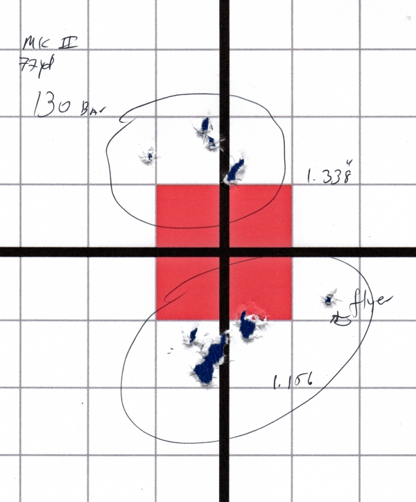

130 Bar
1.247" Ave Group
832 fps

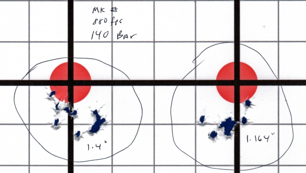

140 Bar
1.282" Ave Group
850-60 fps

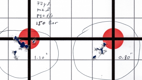

150 Bar
0.95" Ave Group
900 fps

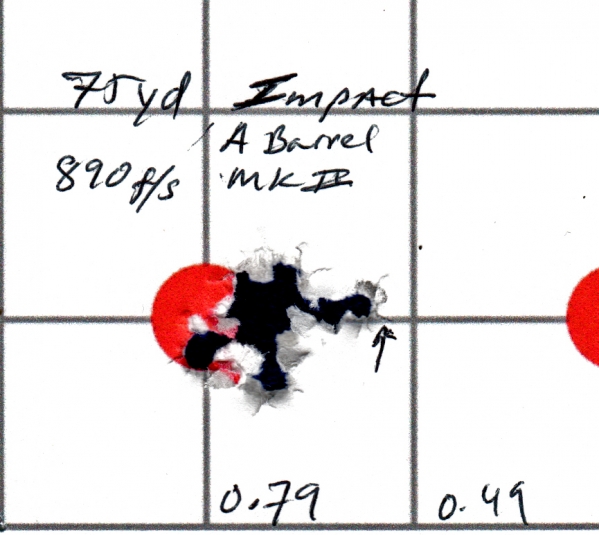

For grins, I decided to try shooting groups on PW 4, 5 and A. Here's the target for A which was best. Think I'll leave it there for a while. 😛
0.79 at 75 yds. 10 shots, 890 fps., 150 Bar. The hole at the far right, at first, looked like a flier after the 4th shot, so I measured 0.49" excluding it but I think I'll include it and say 0.79" but 9 shots went into a hole measuring 0.49" I think that's pretty darned good for this gun. And as always...this is my gun.....your mileage may vary.
