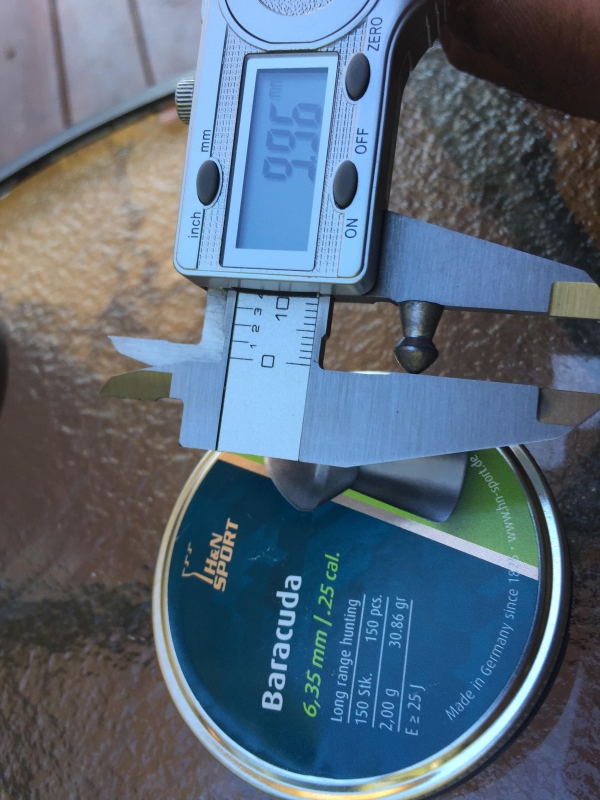

I have the Side-Shot magazine for my FX Impact in both .22 and .25 caliber. The width of the 2 is identical -- 15.11mm.
My Side-Shot magazine in .25 cal will not index when loaded with the H&N baracuda .25 cal which measures 9.96mm in length. Nor will the stock magazine index with these pellets.
Are you saying the 9.96mm length fits in the mag, though maybe too tight to turn?
