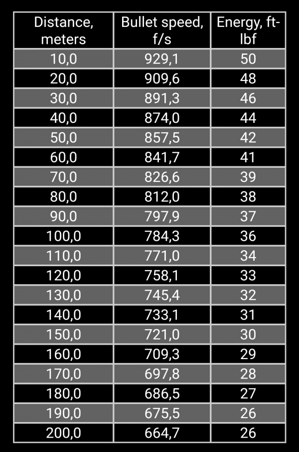

This is the energy chart for a 26gr slug. Pretty crazy numbers.
1548706288_18935634705c4f61f0690789.90135054_Screenshot_20190128-220951_Strelok Pro.jpg
Whoa!!! By those numbers, I could hunt out to 275m!
Even 1/4KM .. I'm going to need a bigger scope
