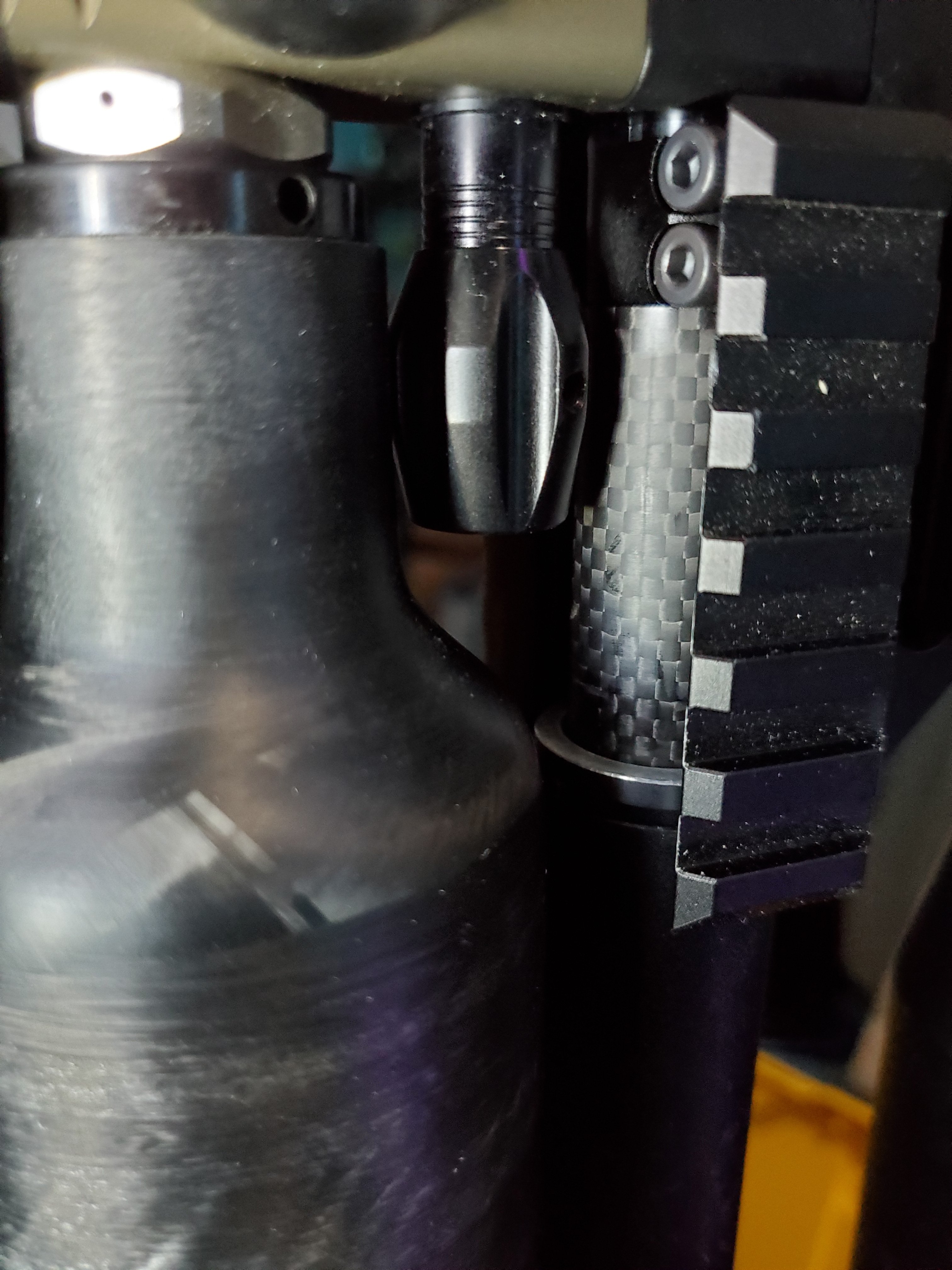

Does anyone know where I can get a modified rear shroud cone for an FX Impact barrel?
I want to install an FX 700mm barrel tensioner kit and would like to reuse my factory shroud. The inside diameter of the rear shroud cone needs to be modified from 14mm to 20mm. I don’t have a 3D printer or machine shop to fabricate my own part.
Nobody sells them that I know of. I bought a mini lathe and modified my own to do this, as you may have seen before here. If you had the specs you want and the oring, a machine shop could do this pretty easily(inexpensively) since it's not crazy tolerance dependant. Plus the carbon shroud is epoxied in, but the factory cap can be removed from the aluminum shroud. Id possibly be willing to trade my aluminum tail cap for your unmodified one if you wanted to pay shipping for the labor of it. (not pictured.) it is sized to the fx tensioner tho.

The 3d printed one may work depending on the filament used but the print quality is is pretty poor imho. If it is abs, there's tricks I can fill you in on.
I have my aluminum shroud modded as well as my carbon fiber, to fit the outside diameter of the fx tensioner. I will trade you my machined one for your stock one if you ship yours to me at your expense. I will then ship you the used finished one with an o ring as it is, in trade, if that interests you. If not interested, no biggy It will remain in my barrel parts box otherwise. I'm glad to see others interested in doing this mod without feeding fx and their drip-feed modifications(you know they'll never sell a cap and it will have to be a full shroud) getting you to perpetually spend money.
