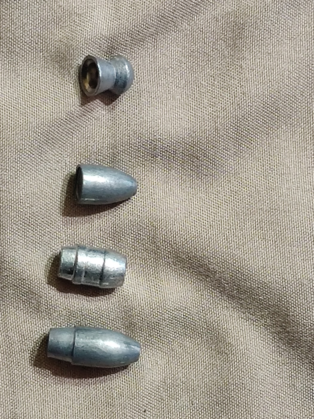

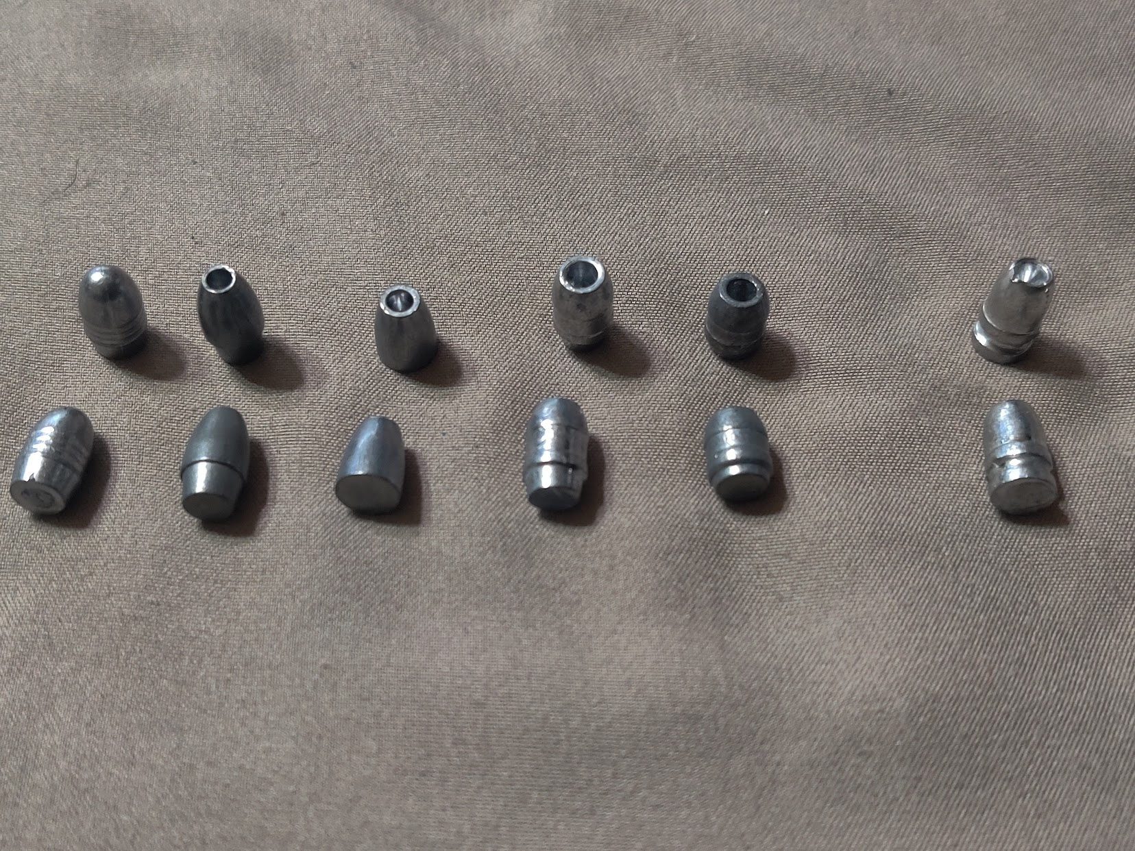

I can's say much for the "Impact" or any FX rifle. What I will say is that the "TRUE" id of the barrel determines what slug to use. Too tight or Too loose will never give you the sub moa accuracy that your rig is capable of shooting. I with Bamavet55 on the Zan slugs for my Mrods, NSA has a .250 that my rigs like, and the BT65 like a .253 slug at 40 to 56 grain. Do a push through and measure the grooves to find out what size slug needs to be tried. There are many different ones out there. Below are just a few that I use.

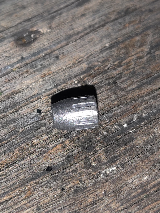

To push a pellet or slug through the barrel, I use a brass or aluminum cleaning rod. If your barrel is choked, it will start off tight and then almost fall through. If not choked, it will have a light drag all the way through. Don't get in a hurry, a few light taps may be needed to get things started.
Once the projectile is out, it will be similar to the below pic. You'll see that landings and rifling grooves. Make your measurement from there.
