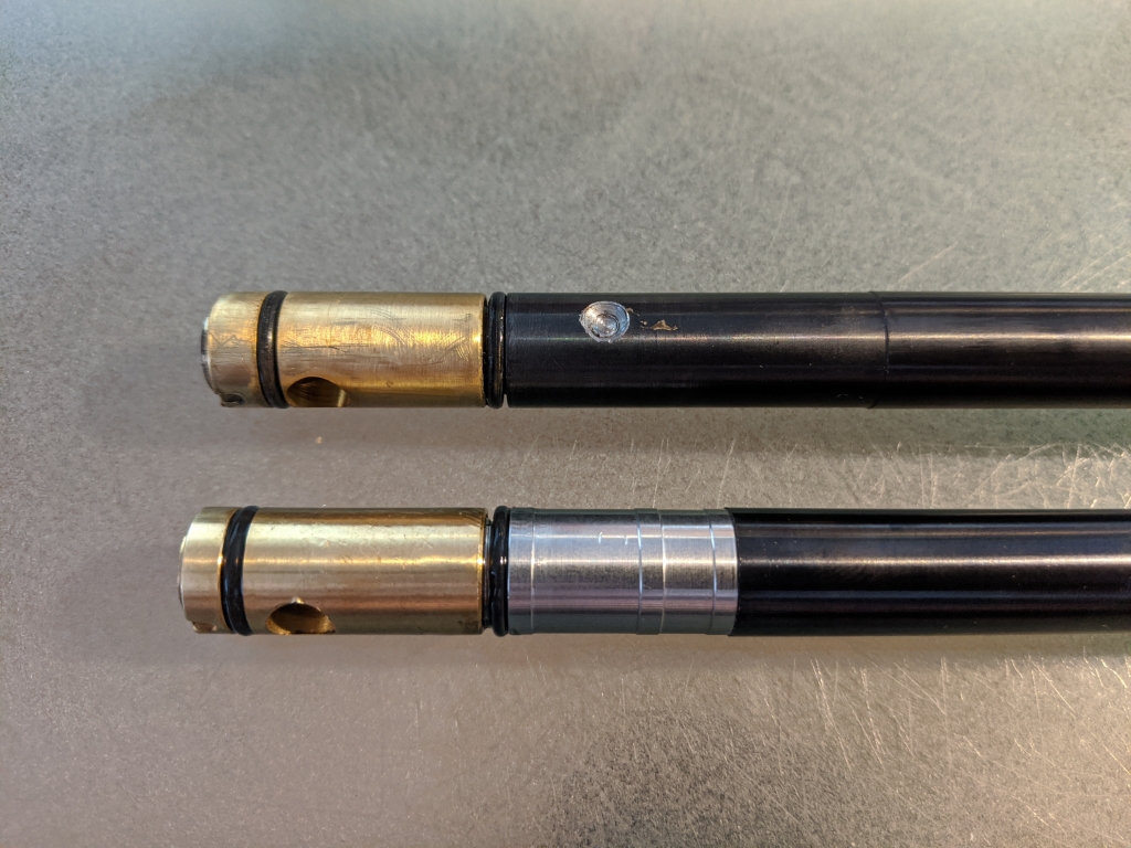

Impact: New 700mm barrel, no locking dimple for the setscrew.
I got a new barrel for my 'old' Impact.
There's no setscrew dimple for locking the barrel in place? Am I supposed to take a drill to this brand new $450 barrel?
Thanks in advance

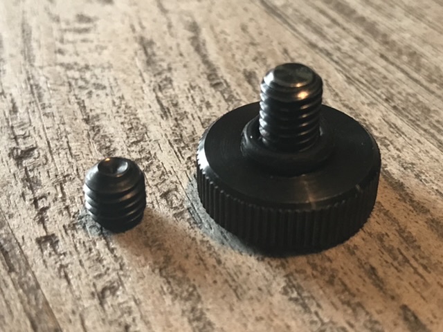

They changed it with the introduction of the X barrel system. Potential issue can be that the old round screw that falls into the dimple doesn’t have enough traction to hold the new barrels in place, in my old Impact the new barrel slowly creeped forwards.
Krale send me the newer “X” screw for free when I mentioned this which solved the issue, you can also drill a dimple to make it work with the old screw.
