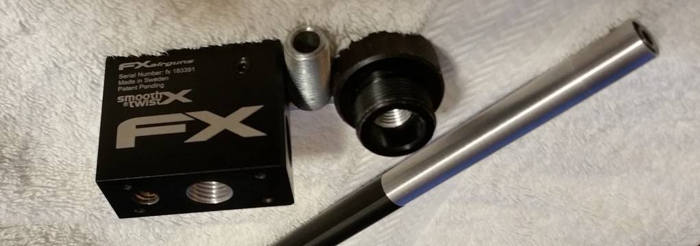

You can also use a barrel extension on the 600mm to run a 700mm liner. That's the way my .22 barrel is now.
