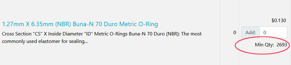

The O-Ring store does list that size, but the minimum quantity for order is 2693; at 13 cents each that would be about $350. But they are out of stock anyway. Seems like 6.35X127mm is a really oddball O-ring size.

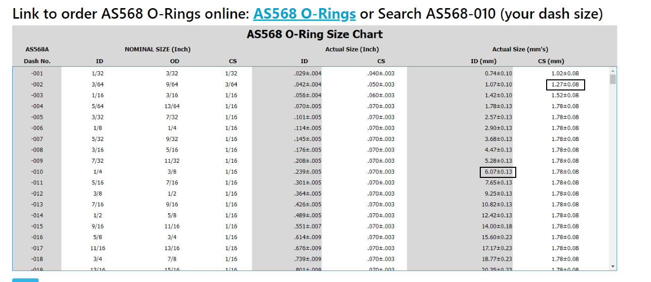

Hawkeye, please don’t take this the wrong way because I am genuinely just trying to help. I think you are really making far too much out of this extremely small size difference. I have pasted a very small portion of the O ring size tolerance chart from ‘Theoringstore.com’ and highlighted a couple of areas that I think are of interest. If you look at the ID tolerance for a ≈6mm O ring it is ±.13mm, and if you look at the CS tolerance for a 1.27mm O ring it is ±.08mm. So the O ring that you are trying so hard to get ‘right on the money’ (6.35 x 1.27) could actually measure anywhere from 6.22mm to 6.5mm ID and 1.19mm to 1.36mm CS when you add in the tolerances. I guess I just don’t see the need for worry; the O ring is rubber it WILL conform. Also attached a link to the whole O ring chart.

Thanks, I understand what you're saying. I'm trying not to overthink this but I'd like to get an answer:

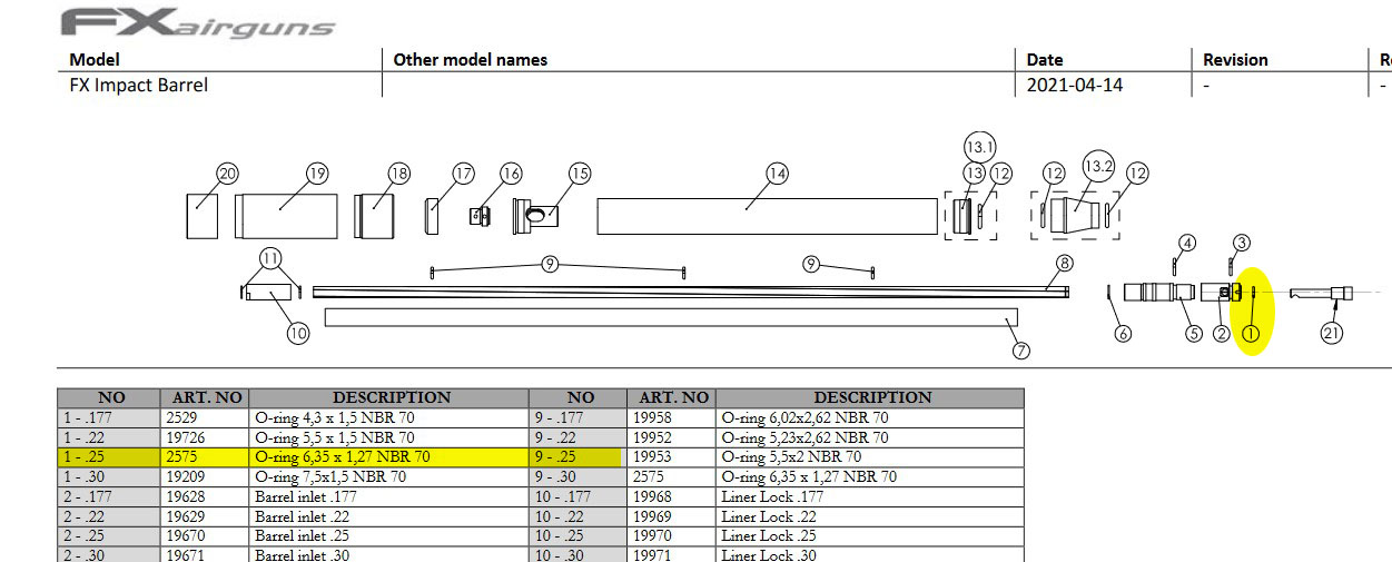

I emailed FX and was given part #4526 for the o-ring, but that is the part number for the M2 O-ring which is 6.4 X 1.3 mm. The part number on the FX M3 barrel schematic for the .25 cal. is part #2575 6.35 X 1.27 mm. If the old size fits that's great since FX want's $1.52 each and $9.00 shipping for them. I have 25 of the old size but I haven't tried using them yet as the breech o-ring is likely to get damaged if I try to remove it. If they don't fit right and I damage the old one, I'd be screwed until I get the right size.
I responded to their email and asked for clarification as to the part# discrepancy and confirmation on the size. As yet there is no answer.
I'd be curious to know if anyone has tried the old O-rings in the new M3 .25 barrel.
