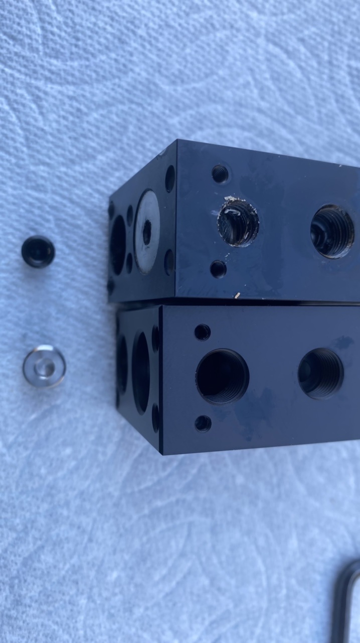

Here is the difference of the TP inside of the block between old and new power block:
You really have to love the customer service at FX. Let's hope they never decide to change it...
they are always trying to upgrade as they gi which kinda sucks but would be nice to know these things, fx should let the people know these things so we as consumers know this. im glad they sure do upgrades but for pete sakes we gotta know these things here this fx usa
