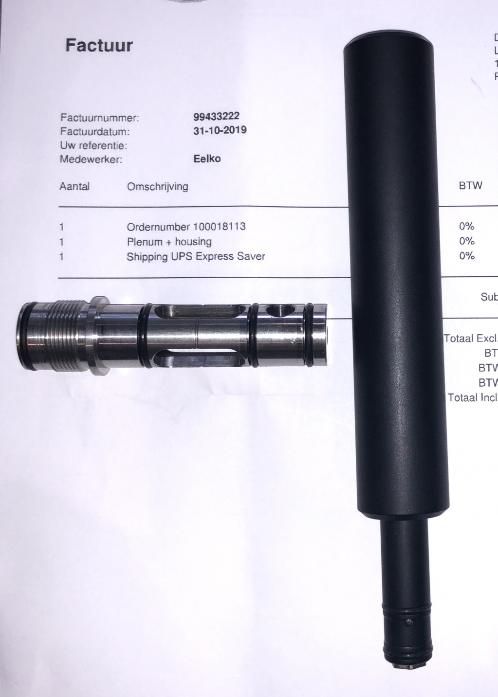

It's not a good investment anymore. There are far superior power parts available for a lower price. If I wanted to buy an impact today I wouldn't buy a MKII. I'd buy a used gen 2 or 3 and use the money I saved to purchase the 75cc eccentric plenum (air tube) from Poland $140 shipped, drill the valve seat to 1/4" (6.35mm) and do an elongated single port. For much less money I would have a gun that can do anything the MKII can and have 30% more power on tap or greater efficiency. A Huma regulator is also a good investment since FX's craptacular plastic piston is a roll of the dice. The "amp" regulator didn't solve any problems.

The big air tube is plug and play and you'll have 50cc more plenum volume than the MKII. It's the best single upgrade available and only costs $100 + shipping.
http://www.airguntuning.pl
Ernest,
This is humongous! FX dealer here is selling the .30, 700mm Slug Barrel Kit (with the sleeve and suppressor). I refused because the Impact X might be too slow to push the .30 cal slug out. With this humongous one, will it push the .30 call slug properly?
