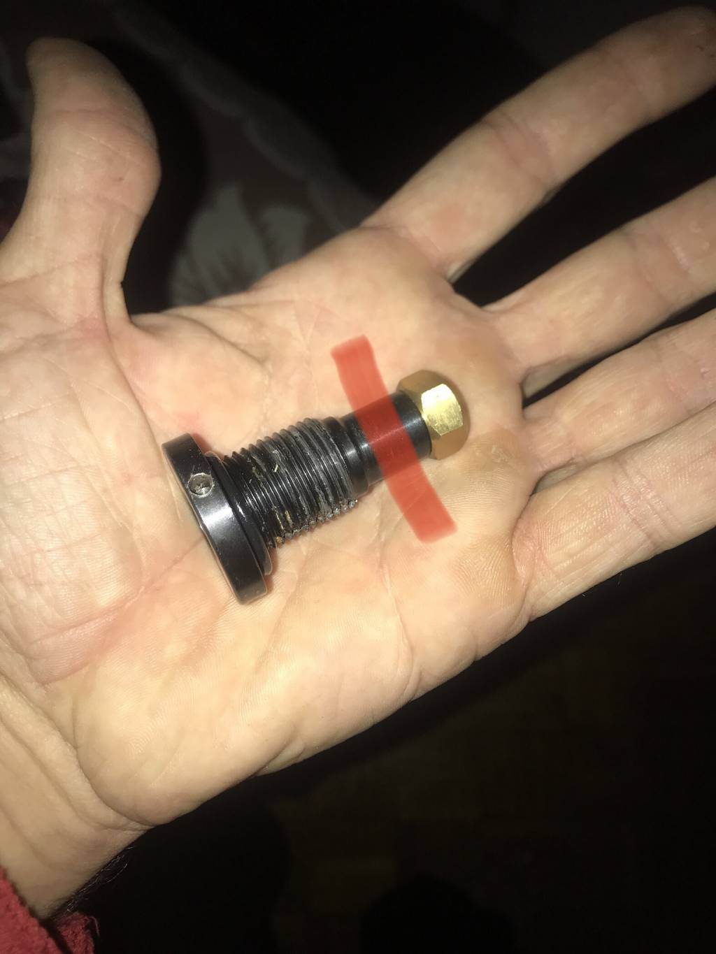

I guess it wouldn’t matter until I got one but you say “ unscrew the nut”. I’m assuming you are talking about the large brass nut closest to your fingers and wouldn’t unscrewing it make it longer? The red tape indicates where it’s going it get shorter?
I know how difficult it is to explain something like this . A video would accomplish it in seconds but trying to describe this when the other guy doesn’t have a clue or even a similar piece to look at is not easy. Appreciate your effort to explain.
Seems like a worthwhile modification.
yes it has to be shortened to the red line

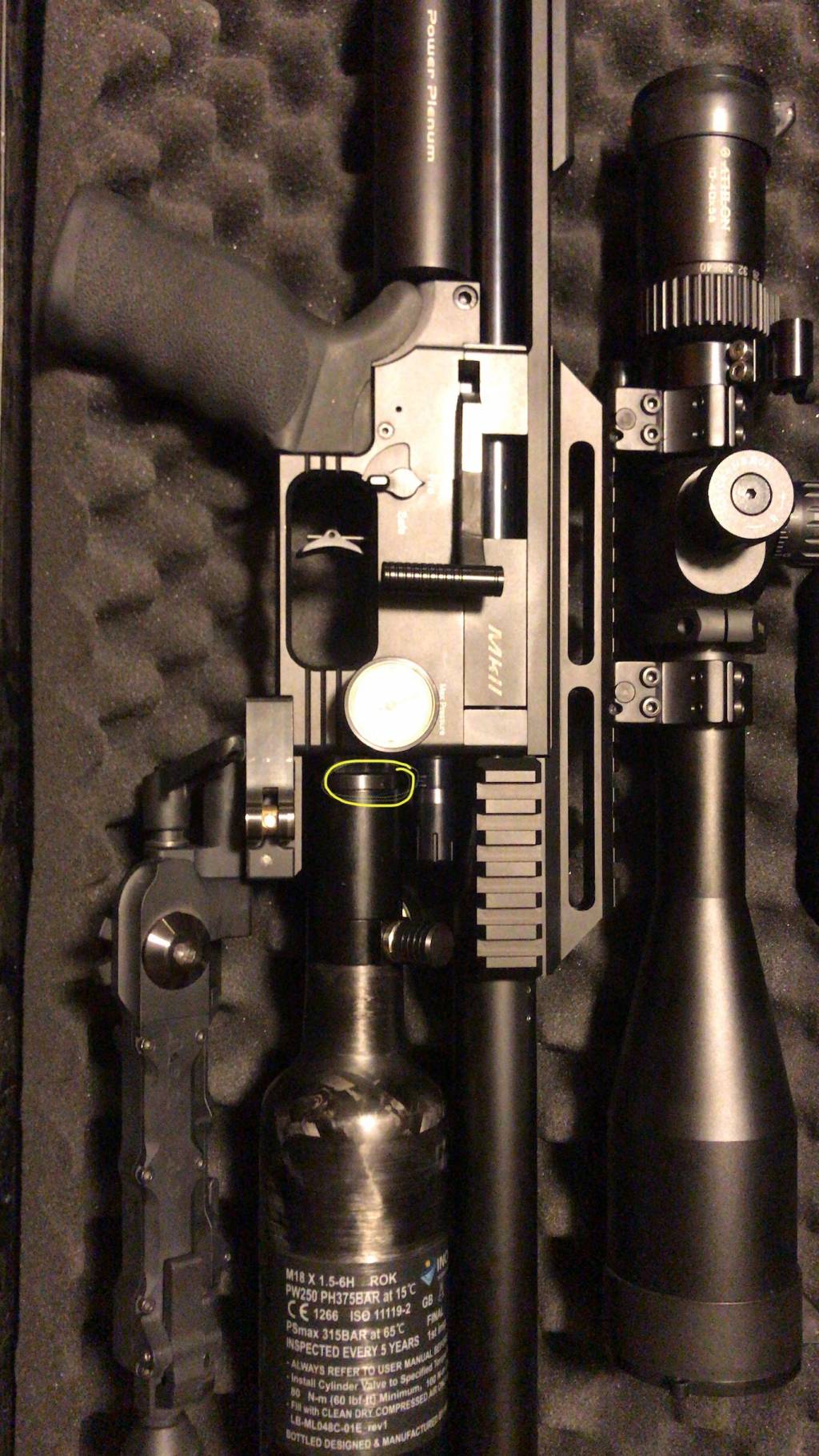

You cAn do And extension but The bottle will Be extended More to the front
Regarding the valve that i modified its still operate as normal when using it if i remove the huma i did Make a New threaded In case i want to add it back to normal
Okay cool. Yah modifying the valve itself like that is out of my league but I'll see about getting an extension made. Wouldn't have to be very long and I can put up with the slightly odd looks.
lol fun times trying to tune a impact that degases the bottle and not being able to adjust the reg pressurized... Makes sense to tune the gun to the second reg pressure... then install the reg adapter and set the 1 reg pressure.. Knowing FX they're probably reading this post and will be releasing a dual reg solution for the impact shortly.
