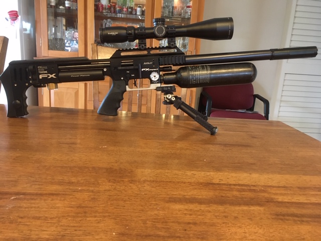

I have a impact mk2 .25cal with just a probe and tp modification, on max it’s shooting nsa 36.2 slugs @915fps and jsb 34gr @ 945fps. Now with that being said to have the same poi from 50-75-100yds, the power wheel is on max for slugs and power 5 for jsb34gr. Also I shoot jsb .25gr @890fps on power 2, and 860fps on power 1 all with very consistent speed. So my question is will be able to do the same thing with the power plenum but with better efficiency? Thanks
Yes the power wheel will still adjust/effect speeds.
