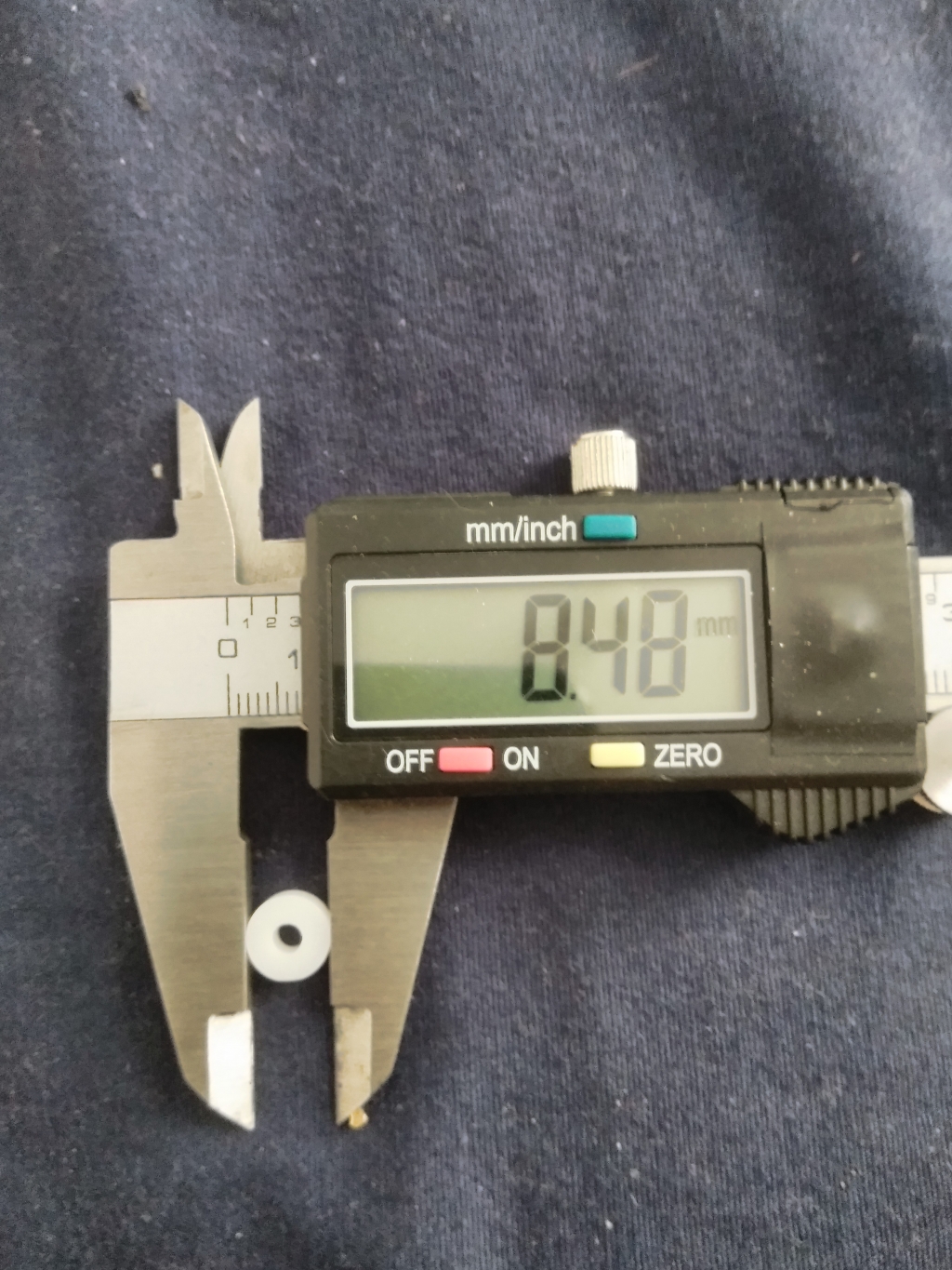

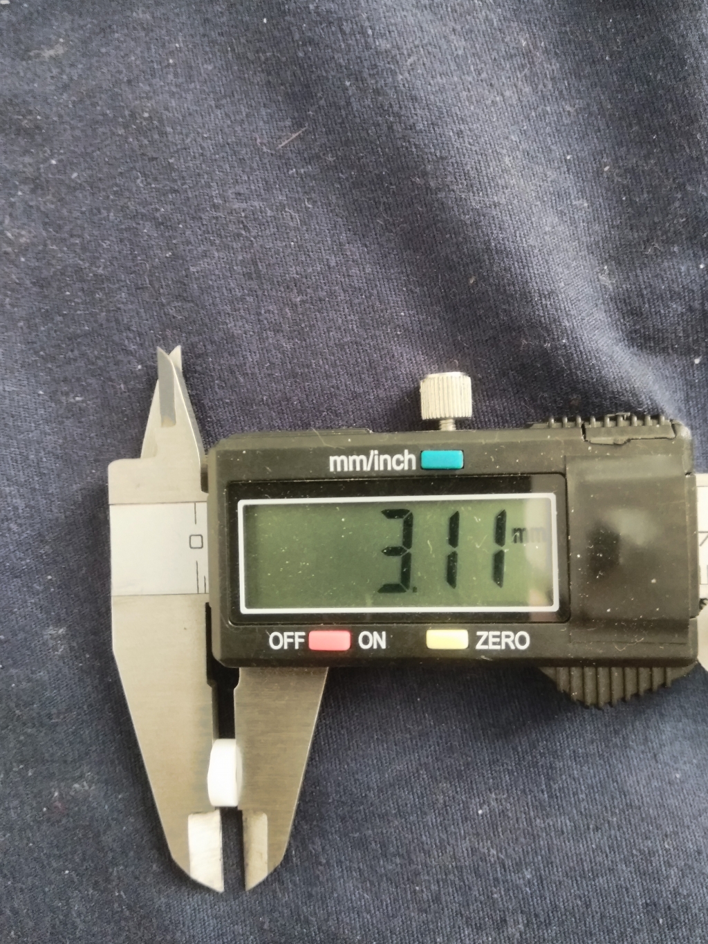

Do you have a compressor like a yong heng or hatsan lighting. They usually ship with the white delrin washer. I just use the one that came with my compressor. These washer are use to seal fittings no stop leaks. I have fire over 2000 pellets though my gun and havent had a problem since I replaced the c3 o ring. If you dont have the darlin, you can order from aliexpress. You get like 50 for under $5 shipped. but shipping is 3 weeks. If you cant wait fx probably have them but shipping alone is $8.
https://m.aliexpress.com/item/32874612295.html?trace=wwwdetail2mobilesitedetail&spm=a2g0s.9042311.0.0.67054c4dBCkrER
These are the one that came with my hatsan lighting.
