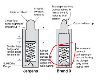

I don't have the M3 but only the MK2. I have polished my trigger parts something similar as EstebanF show it in the other post with some extra steps.
You do your homework with your trigger first stage, I can help you with the second stage ball plunger screw.
A first and quickest fix is lube the ball plunger screw spring inside with something slick, let say ptfe aerosol (I have these for lubing my bike cable wires, brakes, shifter parts).
As a second, you can get these adjustable ball plungers and you can take those apart and modify the length of the pin length or shape as you wish, but the most important is you can polish inside the spring hole.
My trigger parts were polish to an extent that when I get to a second stage and still pulling the trigger per microns I could feel the spring is rubbing inside the plunger screw. I purchased several of the screws from several different vendors hoping different fabrication processes and different spring specs.

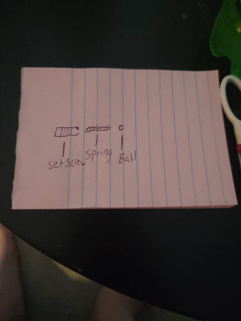

I was able to remove the ball from the detent and found that spring was really long having a lot of compression on the spring giving a heavier second stage I used a punch carefully tapped it out shortened the spring about 2 to 3 coils and pushed the ball back into the set screw with shorter spring definitely lightened second stage also polished and lubed sear areas and shortened which helped to I may have to take out the detent and tap it down alittle more to help crimp the ball in place also took the trigger shoe all the way down til it just cleared when cocked second stage is definitely lighter and still has a wall breaks clean but shortening the lower spring seems to have lengthened the second stage some very simple design thanks for the info

Dear,
As you know that I have made a complete new setup for adjusting the plunger spring gradually and as per need of every user.
But I would like to know that the details of procedure that you adopted to lower the spring strength.
Did you push hard the grub screw from that end in which the alkey enters or you pushed hard the ball into the grub screw.
Will you please elaborate a bit.
What mechanism is inside the plunger screw?
Can you draw pics for my keen understanding?
Bhaur

I took a small punch and went threw the side the Allen wrench fits on and tapped it out it is just a hollow set screw with a ball and spring
Please forgive my art I shortened the small spring so it was just maybe a coil or to two over the hollow set screw with the ball and spring back in place I tapped it back together on a hard surface to put some bend back onto the part that holds ball into place the small spring in place is pretty long I was surprised at the length of it I also shortened the other trigger spring and polished engagement areas of the trigger carefully not to change any angles just to smooth it out then just dropped the trigger shoe to as far down as I could and still clear when cocking
