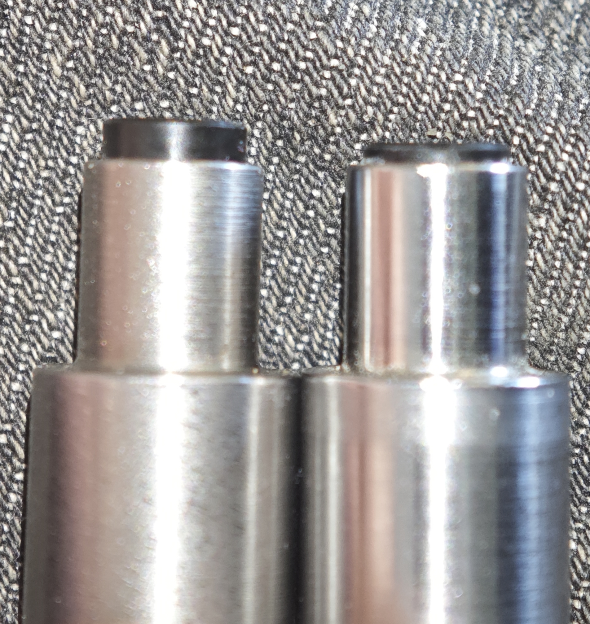

Also wondering if anyone can explain what the realistic differences are between the two hammers in the picture. They weigh a similar amount but the black delron part(C3?) is quite a bit longer on one of them than the other. Has anyone got any info?

Second concerning your hammers, don’t worry about it. The delrin is there so you’re not metal on metal hitting the C1. I have three extra hammers in with my stuff and the Delrin is different on all three.
