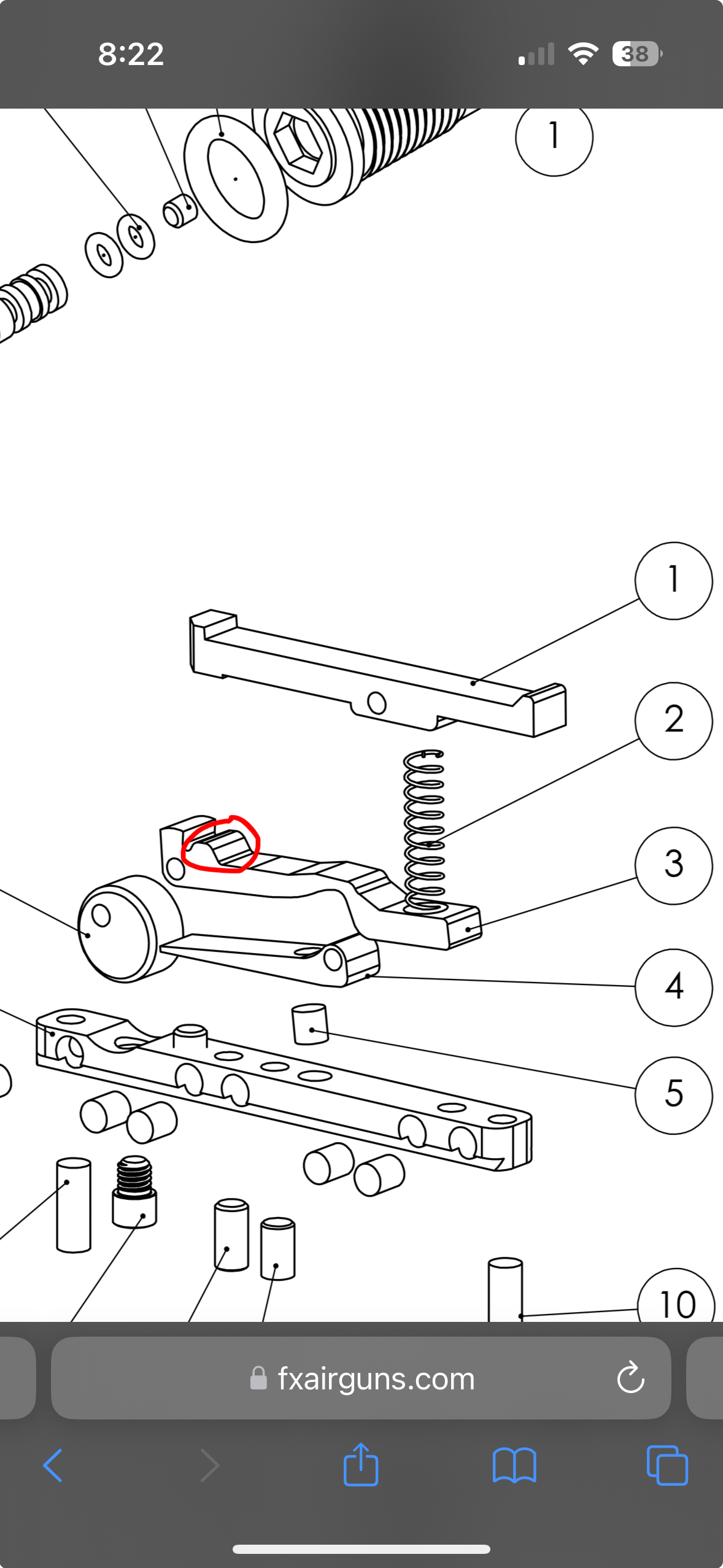

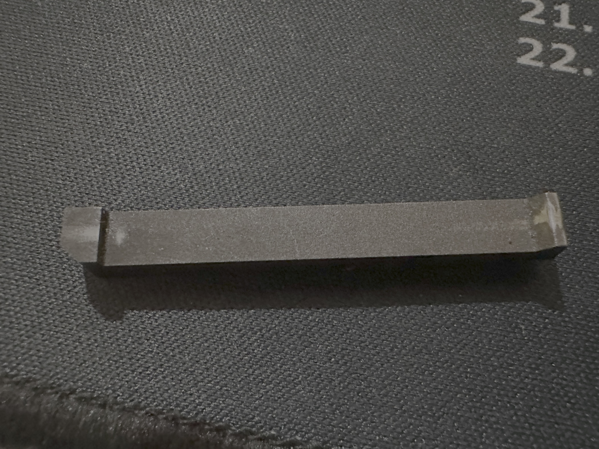

I then took the sear out just to check and the part that’s pushing the sear up so that it catches the hammer (the part the hammer seems to be riding on along its length) was pretty beaten up, see pic. Polished the sear up to mirror while I had it out but also checked the schematics and it seems they changed a part of the trigger, part 3 on the trigger drawing (well, at least the one I have is not the one on the exploded view…). I then went to see what videos are out there and the part I have is the same in Ernest’s video. Sub12 has a video on the trigger as well and he has the one that’s on the drawings… which has a bump holding the sear up, I’m guessing to avoid the wobble and the hammer riding on back part of the sear?! Obviously I’m now wondering To what extent this affects consistency… Anyone knows anything about that?
