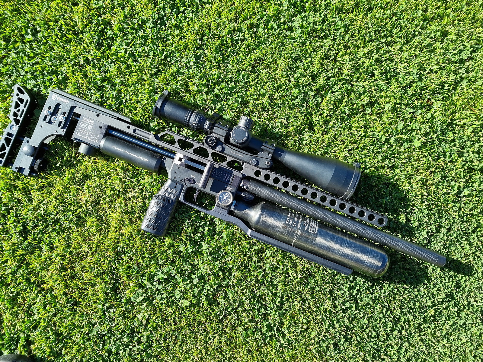

Get an airmarksman top rail and throw that saber tactile out the air marksman rail seemed to cure most of my m3 problems
Fitted..
I put an air marksman backbone rail and a Bullet central CF shroud barrel tensioning unit and a FX CF liner on my .25 700mm and love it, I put it up against my RedWolf’s or my larger cal. RAW’s any day!
Maybe I got lucky? But it’s extremely accurate and consistent with no issues at all and I have put a 6-8 tins of pellets through the gun since these upgrades and been extremely pleased , Internally it’s all stock ad basically a factory delivered tune. POI issues are not any different than any airgun I’ve owned.
