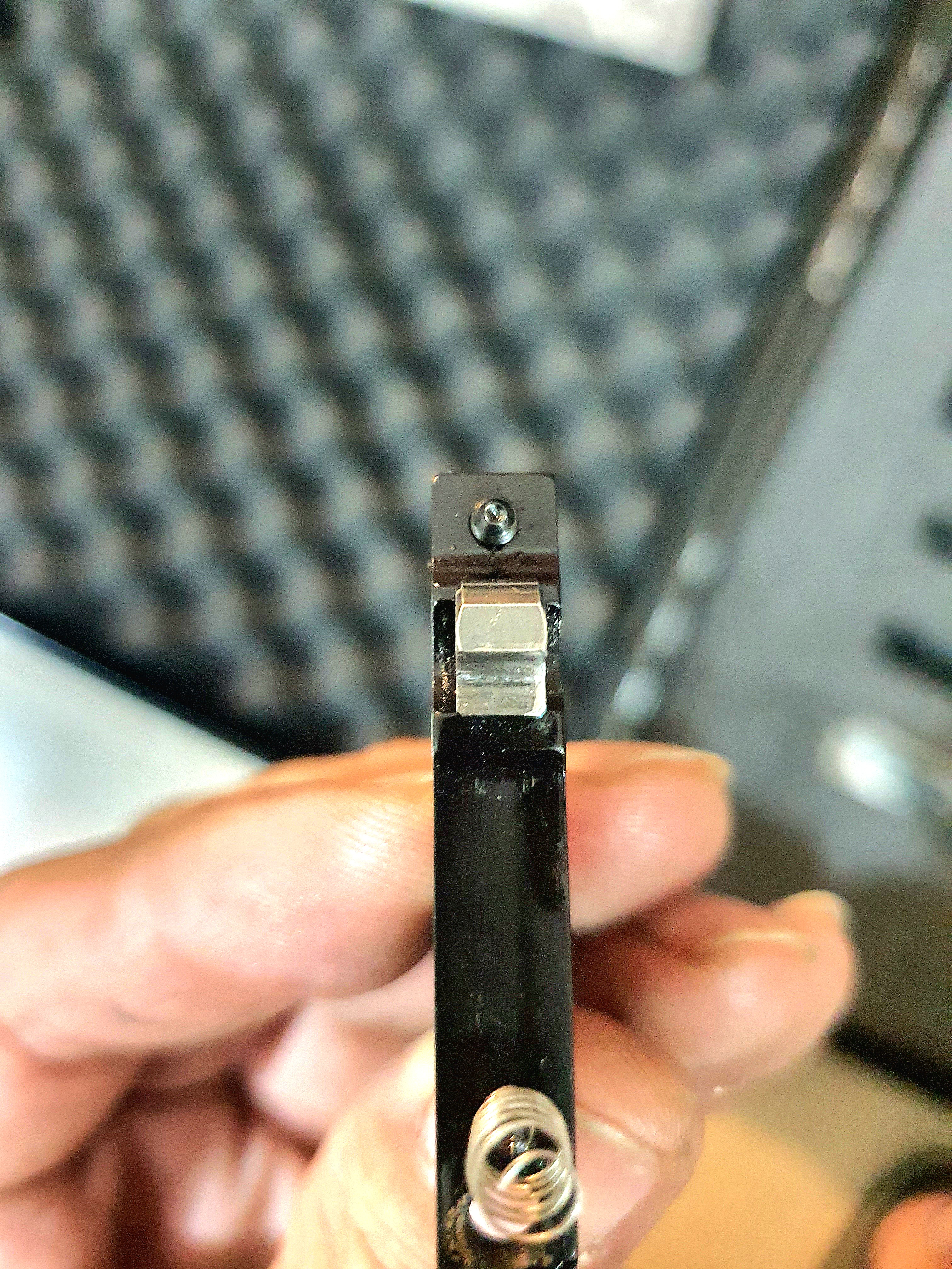

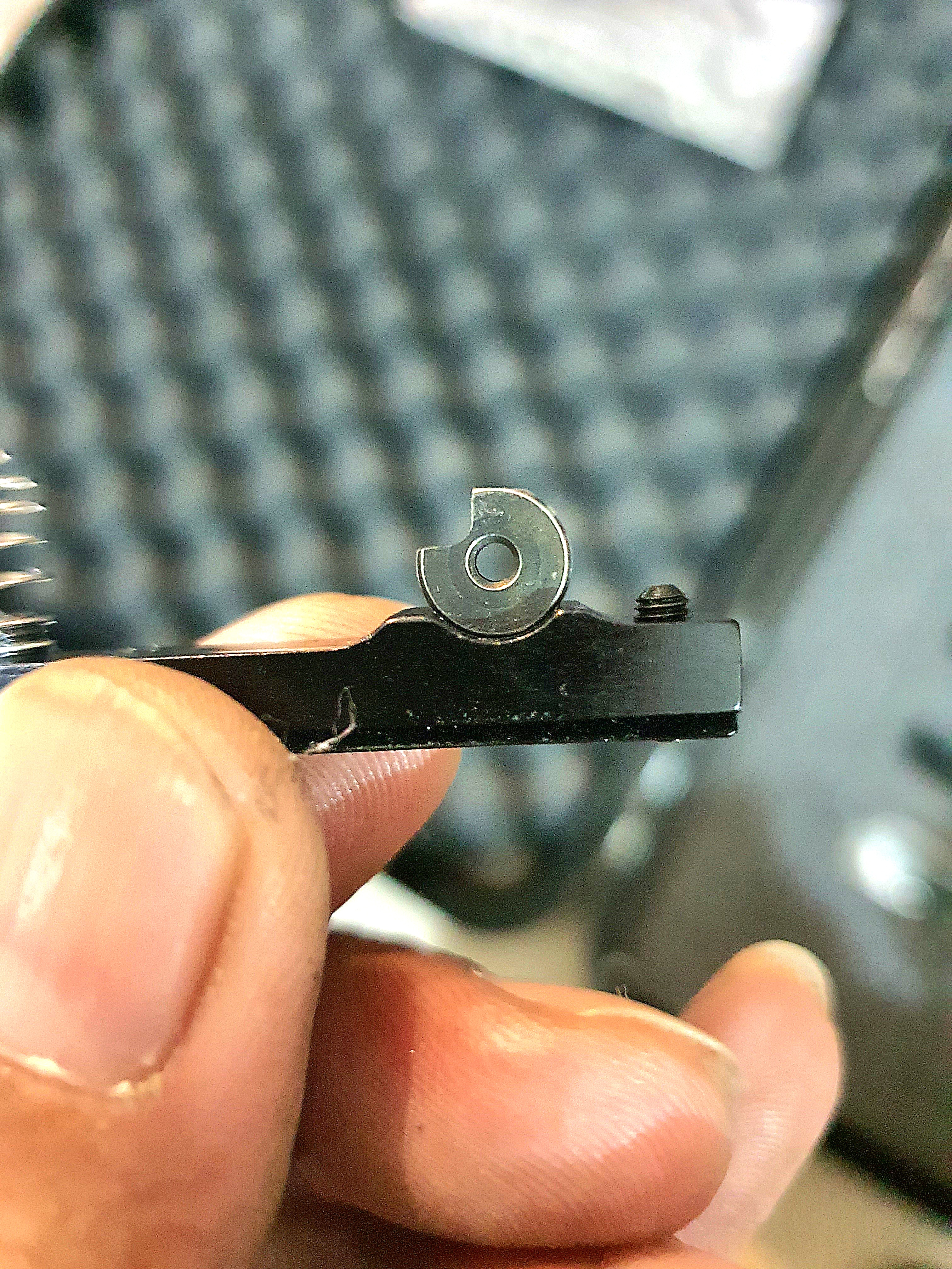

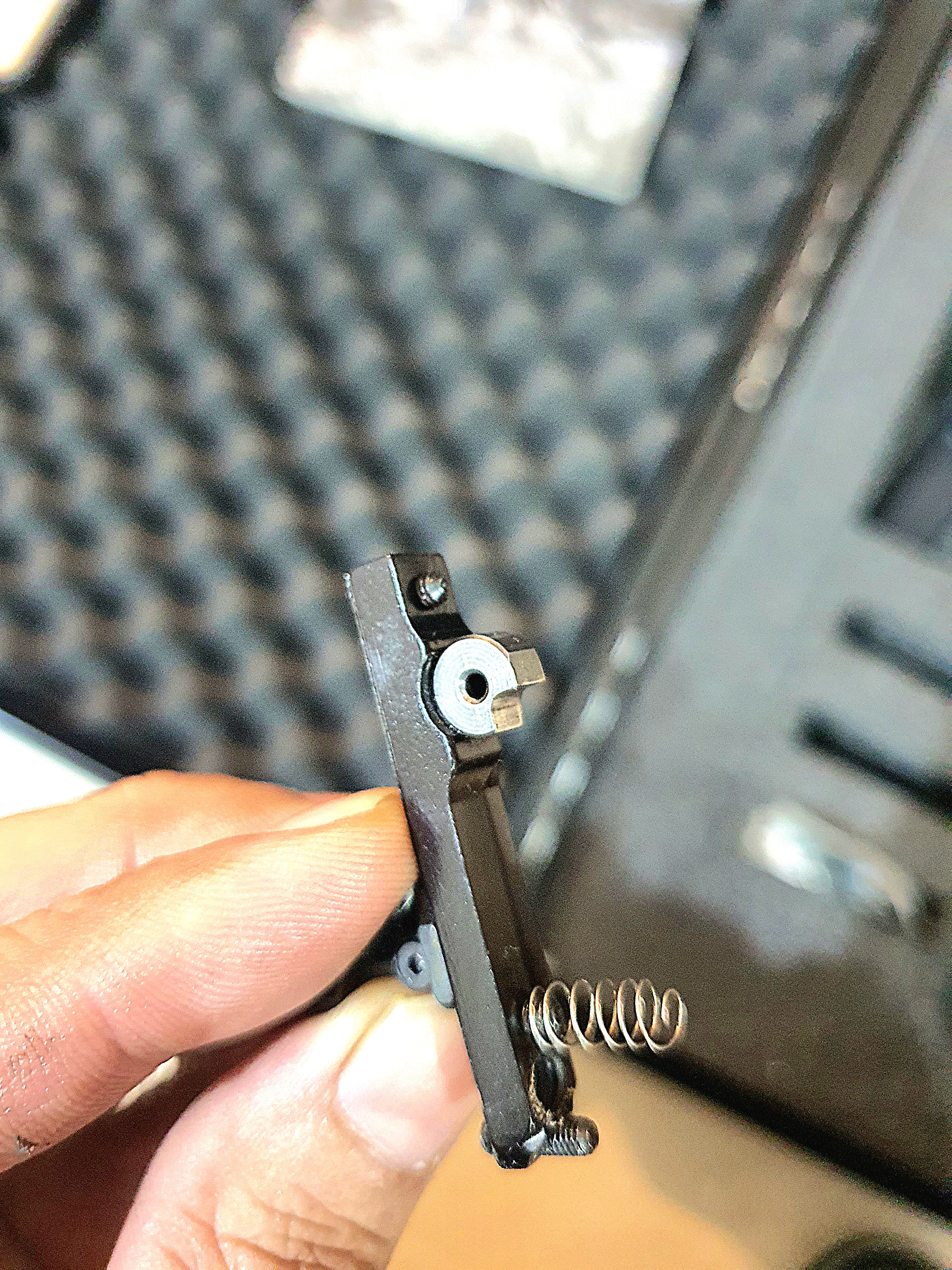

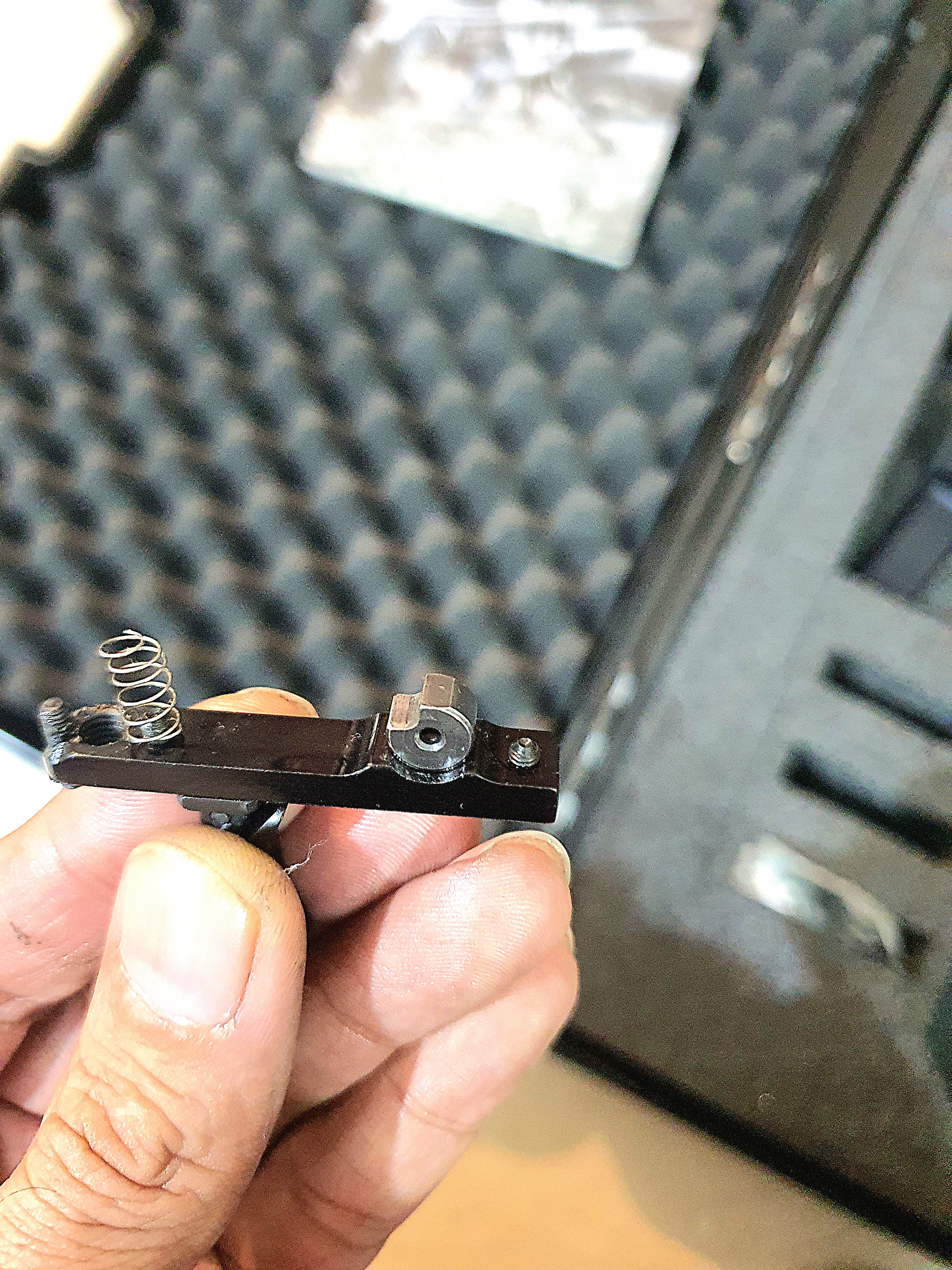

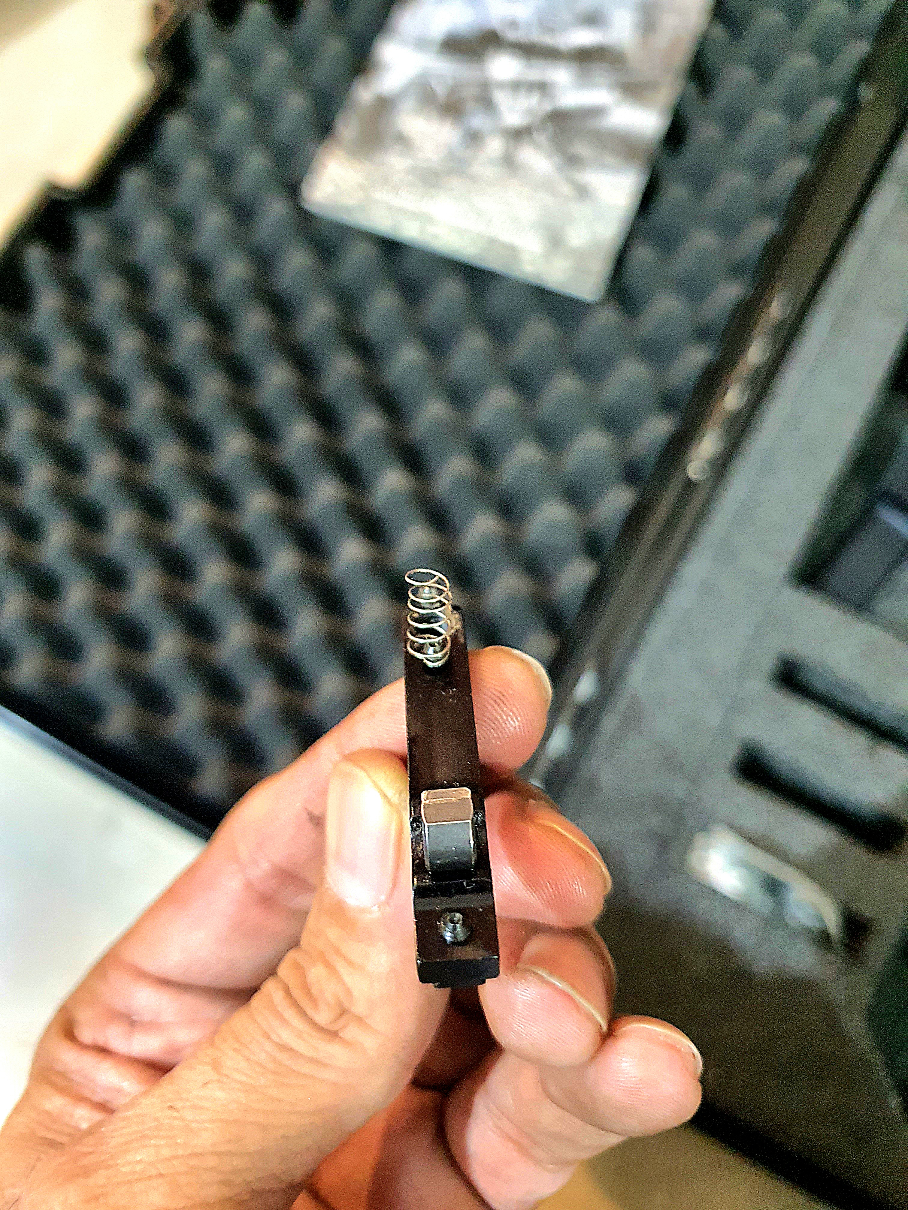

I found that in new M3 with power block, FX has redesigned the wheel sear and the trigger plate.
The upper round surface of wheel sear has been made straight for ease of return of trigger after pulling to the 1st stage travel.
I worked on the gun and the trigger in detail. It's a good improvement but still not upto the mark what me and many other Impact users desire.
I hope that next improvement might address all aspects of the trigger.
At least this effort of FX makes me believe that FX listens to the users and tries to improve the product. Further its good that FX practically acknowledged the issue and tried to fix it.
Pics below.
