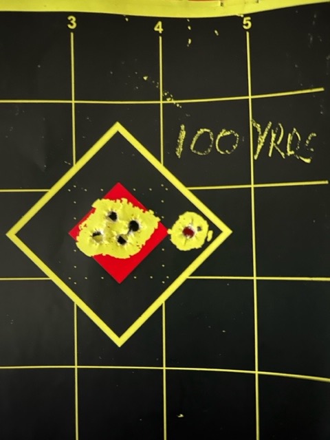

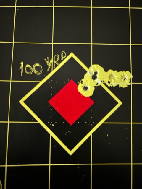

The day was windy so I did most of my testing at 50 yards, verifying the velocity I felt was best and tweaking settings. Once I was happy I shot these at 100 yards. If you don't recognize the target the squares are 1 inch.
I confirmed that my rifle likes the Nielsen 24.5 grain .217 diameter slugs traveling at 990-1000 FPS.
