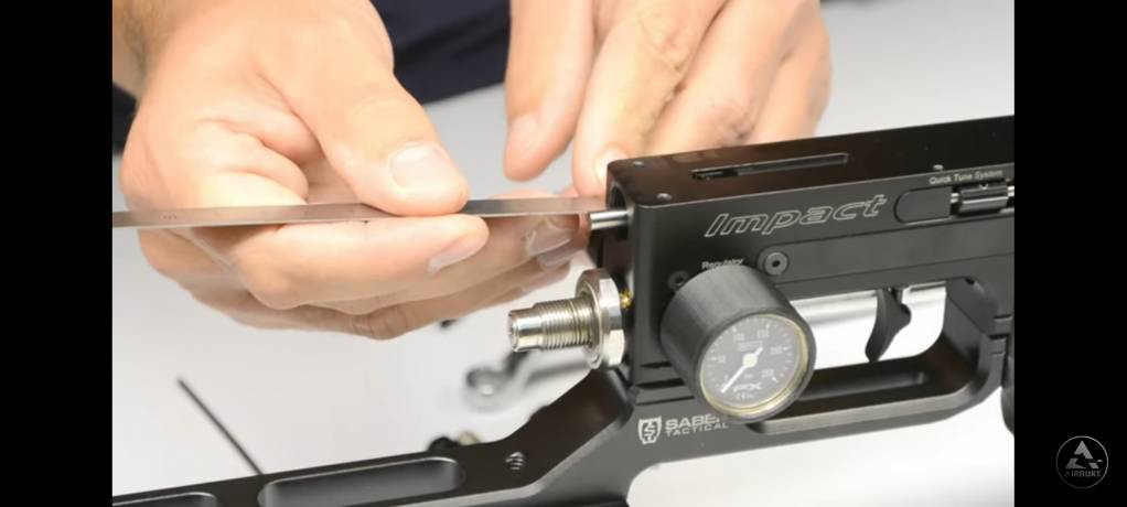

Maybe the C1 isn't adjusted correctly ?
Should be 6 to 6.5 mm

Install the pin probe and 2x hammer spring weights/spacers from the slug power kit, but do not install the valve adjuster spring or rubber balls. Those are not needed on the M3 and will limit valve travel and muzzle energy. Verify your C1 protrusion after installing the hammer spring spacers.

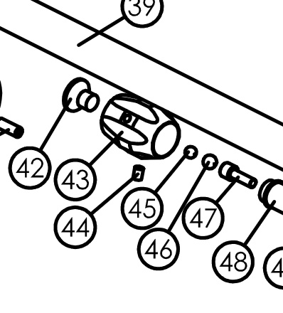

No free floating rubber balls inside the valve adjuster spring on the M3 like there were on the earlier impacts. On the M3 the rubber balls to cushion the valve opening are captive inside the valve adjuster knob itself. Adding the balls from the slug power kit inside the valve spring (like for earlier Impacts) severely limits how far the valve can open and limits power on the M3.
Schematic of M3 adjuster knob, cushioning rubber balls are #45 & #46 and are captive inside the knob.

  2. The C1 protrusion was measured originally at 6.34 mm, now it is 6.07 mm. Can such a minimal difference have an impact (no pun intended)?
