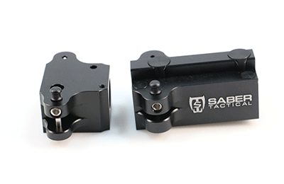

I went with this on my impact mk1 😁

Reloading block is aluminum isnt it?
Nope...pretty sure it's plastic. My gun is the Impact X.
I have the impact x mk2 I'm 99.9% sure its aluminum. What makes you think its plastic? Scratch it in a hidden place you'll see silver under the anodizing.

You know, I think you're right. I stand erected...
The little sleeve that the hammer pin sticks into appears to be plastic and looked integral with the block, so I (wrongly) assumed that the block was plastic as well.
