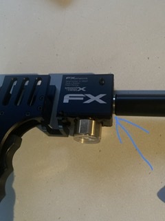

Take the reg gauge off, then the plate below it (4 screws) then you'll see a big 5mm hex head screw. Unscrew that then slide the block off the valve house.(towards pictures left). You can inspect the orings on the outside of the valve house. It's most likely one of those.
If not its probably the one on that end of the plenum. Either way you gotta go just a bit deeper.
