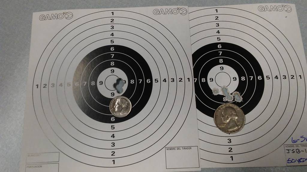

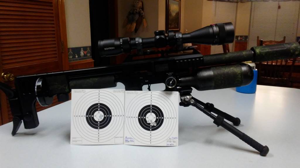

Here's a couple pics the pic with the dime is with the new liner and a random only 3rd shot group I just shot a few minutes ago @ 930 fps with 16 grain JSB plus seven shot group with some swirling wind.
THE other pic with the quarter is with the old liner @ 50 yards and is hand cherry picked best of the very best after shooting the slugs through the old liner.
Its a 500mm .22 superior liner in both cases.
Others post excellent results swapping back and forth, I have no reason to disbelief, but my experience is my experience and no one can dispute because it's my experience. I'm only giving my results and experience AND THE SLUGS DID IN FACT RUIN THE ACCURACY IN MY particular liner for pellets and nothing I've tried could restore the accuracy for pellets.
