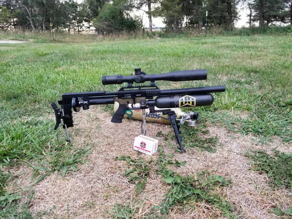

When I switched from high power .25 with a 700mm barrel 75-85fpe to a .22 500mm and 15 to 32+fpe I pulled my hammer spring shim and put the the heavy valve spring back in. Then I lowered my reg from 135 to 110bar and dialed my hammer spring down. Now the gun easily adjusts for my pellet weight choices in the 15-32+fpe range without a problem.

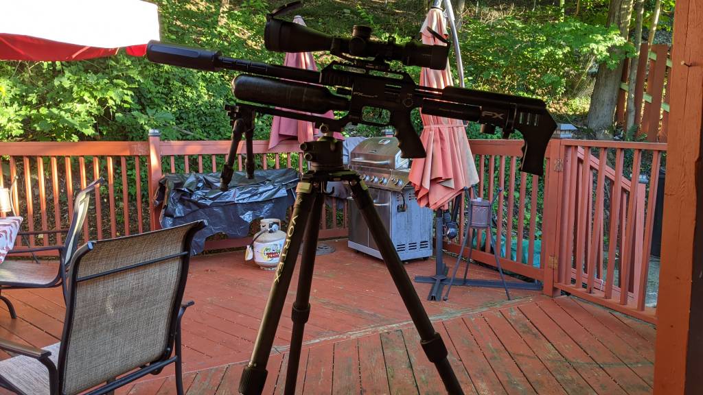

This is pretty much what I wanted. Started off with a .22 700mm set up with the power kit for the JSB knockout shooting at 1024 fps but wanted to shot JSB 18's when I didn't need the fpe. I got a 500mm kit that has a dual transfer port from talontune. I'm still wasting air on the 500mm but having a DonnyFL emperor or Ronin with the Huggett Dedicated Shroud to quiet it down. The reason for the Huggett is that I'm not allowed to hunt with a moderator stated by the Department of Environmental Conservation. So I can take off DonnyFL on public land but still have a Shrouds Moderator
