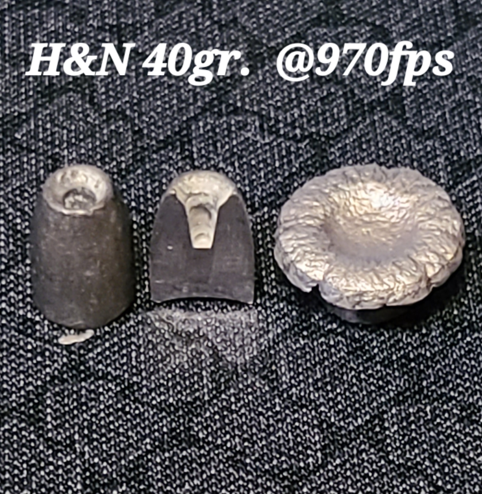

.249 or .250 “ ?H&N 40gr Heavy slug from my M3, 1:16 heavy liner.
These are very accurate out to 200 yards.
They are also the best slugs for hunting I've used.

985 fps in the impact with the H&N .25 cal 38 gr. Heavy. In my .22 impact using the H&N 34 gr. heavy I am shooting them @ 960 fps. In my Panthera .22 the H&N 34 gr. Heavy are going 1018 fps.What speeds is everyone shooting their slugs?
