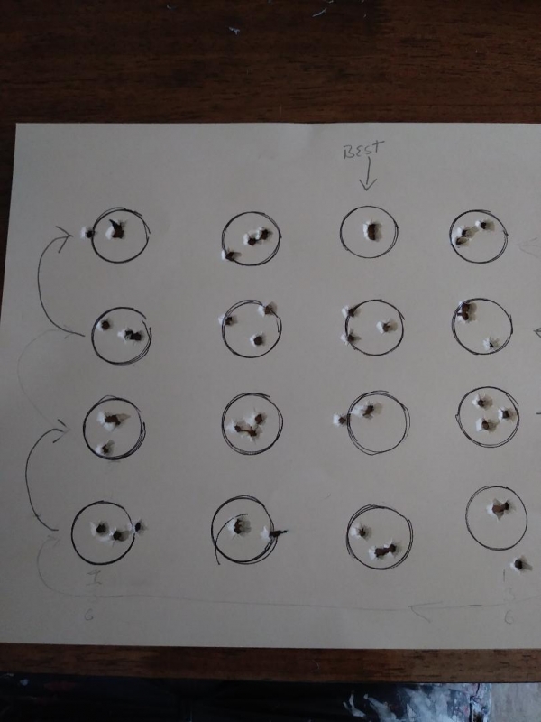

Sorry to hear that about your impact eodman, hope you get it sorted out. I had trouble with my magazine loading heavies, it was tight and crushed the skirts but once i got that straightened out it shoots very well.a few three shot groups after work yesterday with my impact .25 heavies, light wind.57yrds
