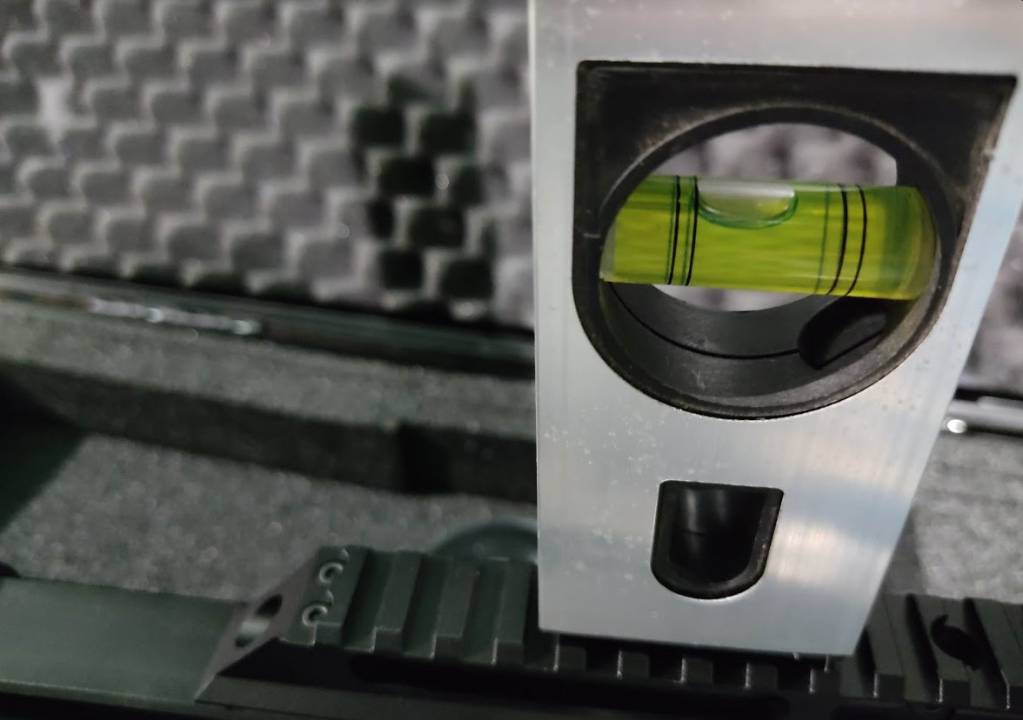

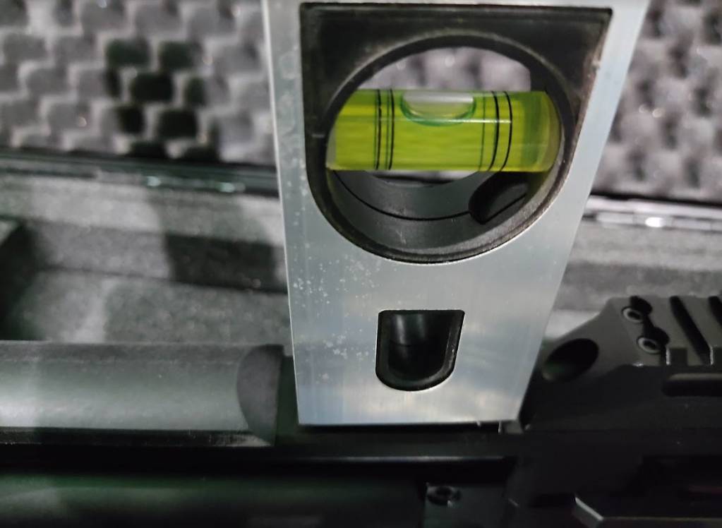

Saw this so measured it.
20 moa is 0.333 deg so close enough

Convincing statements deny the 20 MOA on the new Impact 2 and a convincing picture with a gauge to illustrate suggesting just the opposite. And an inconclusive statement quoted from FX. But Centercut believes there is no MOA on the Impact 2. Is Fast J wrong?

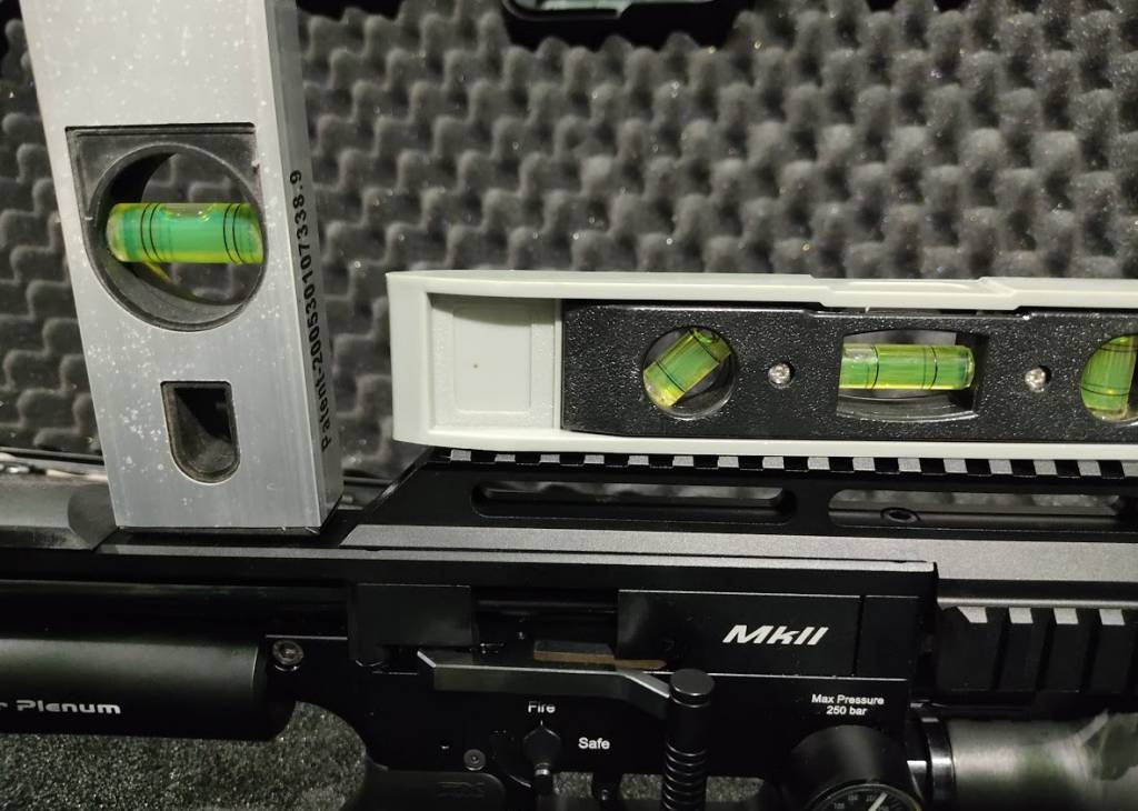

Maybe FASTJ can retake the pic, with a small level behind the scope rail and have it show level, while he has his digital level gage on top of the scope rail, further forward to the end of the scope rail.

The scope mount if you have the 20 Moa on the airgun, would need to be a Zero, as adding a 20 to the already 20 Moa would be too much for sure. I found that I had done just that. Tonight I replaced the scope mount with a zero and can't wait to see how it benefits.
Looking at the pictures and my Impact 2, I can see the tapering line below the Picatinny to gun frame. Its subtle but definitely visible. Sweet knowledge. Im grateful for all the input and now clarification.
