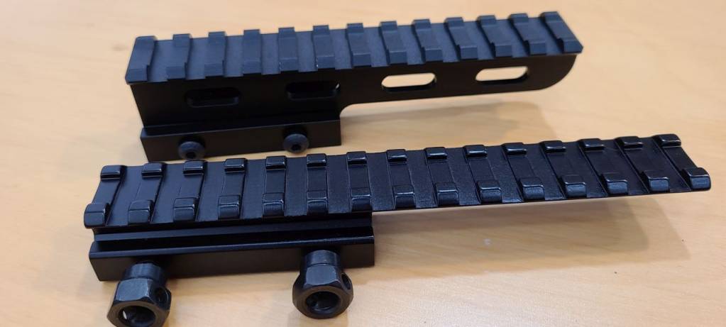

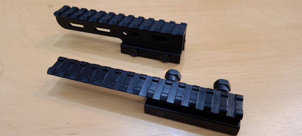

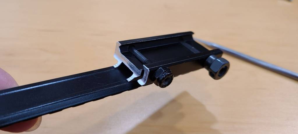

the problem with the low profile rail is that I cannot find a nut that is shorter, too much sticking out from the rail. I don't want to buy a whole box of nuts because I need only one.

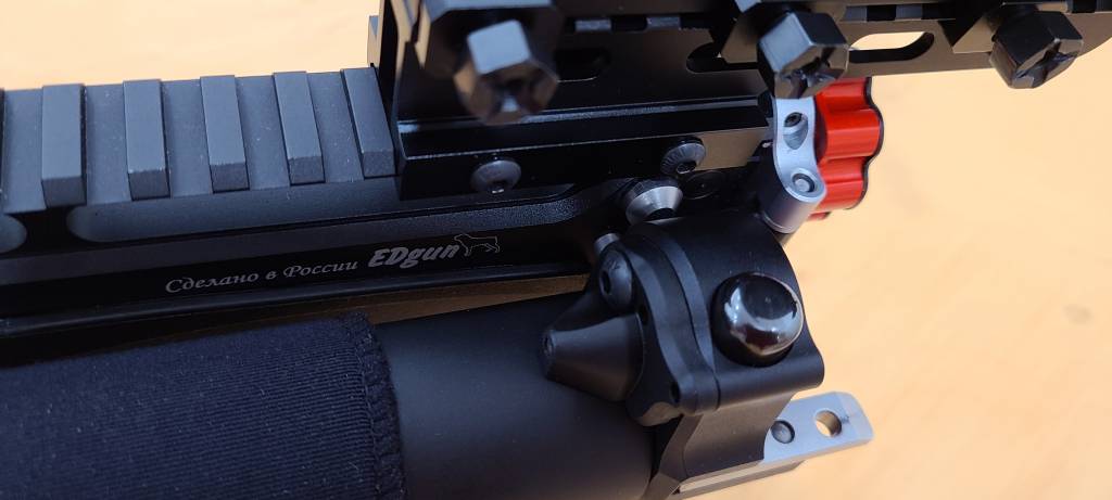

I just installed a Tactacam, on a compact 3-12x44 scope, on a pistol — three things that were clearly NOT made for each other.
I either did not have enough space under the Tactacam for my thumb to cock the hammer.
Or everytime I shoot the gun without the Tactacam (FTS), my eye would be so close as the make the hammer strike on my eye. 😱
➔ So, I had to install a riser rail, and even then the Tactacam didn't fit — or my thumb — or my eye....
After much debating between the practical part of my brain and the part that said "You must keep everything in pristine condition like all the guys on AGN!" — my desire to go shooting won out and I listened to the practical side of the brain.
🔺 I TOOK A DREMEL and cut off an inch of raiser rail.
🔺And I groud off 1/8" off the 25moa Hawke mounts.
🔺And I'm about to take the dremel to the raiser rail bolts and chop off what's not essential.
So, Attila, what's it gonna be? Box of nuts — or dremel...? 🤣
