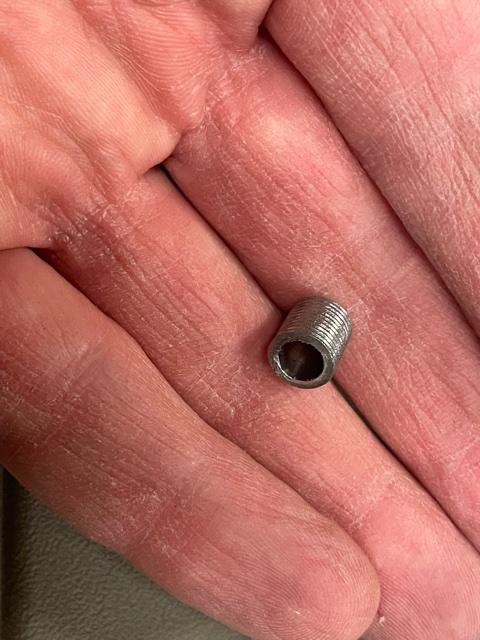

The screws in the fork on the fore end would never stay tight. I would tighten them and 20-25 shots later I would feel the vibration increasing, the screws would be loose again. I would tighten the screws and the cycle would repeat. My fix was to make a pair of pillars and the screws have stayed tight since.

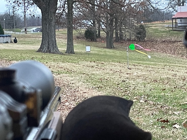

The wind has been blowing here all day but this afternoon it laid down some, 9-12 mph. I figured I'd shoot it some to get it close on zero. I shot the AA 8.4's, Baracuda's and H&N FTT's. The Baracudas have always chronographed well but never shot well, the FTT's and AA's has shot pretty good though. Today in the wind the Baracuda's really shined. The target measured two inches less than 91' from my bench, so I'll call it 30 yards.

Wind flag.
