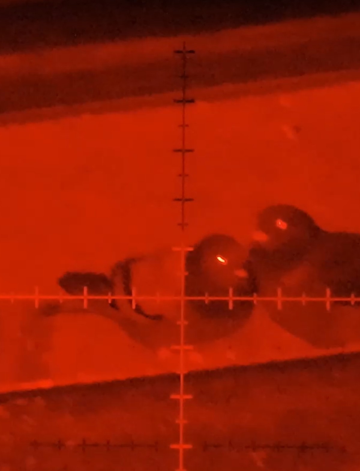

Screenshot_20220808-223905_VLC~01~01.jpgHelps inside the barn at night.
Reactions: L.Leon
